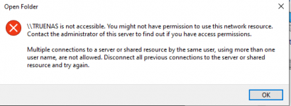

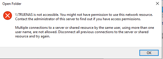

Update:
I migrated to Scale and the Plex installation was a success.
Buttt... I ran to a diffrent problem now. I have 2 PC's to test with. My win 11 one has no problem accessing the server through file explorer. However, my main PC, that is with windows 10 (don't know if this is related at all) can't connect with it at all- gives me "\\TRUENAS is not accessible[...]" I am putting the picture of the error.
nak0
Jun 10, 2023
7
Fixed it, had to disconnect, cause I had it mapped and it bugged I guess and I remapped it again.
