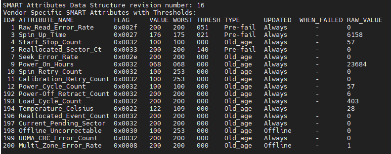

One of the disks that got RMAed at only 23000hrs:

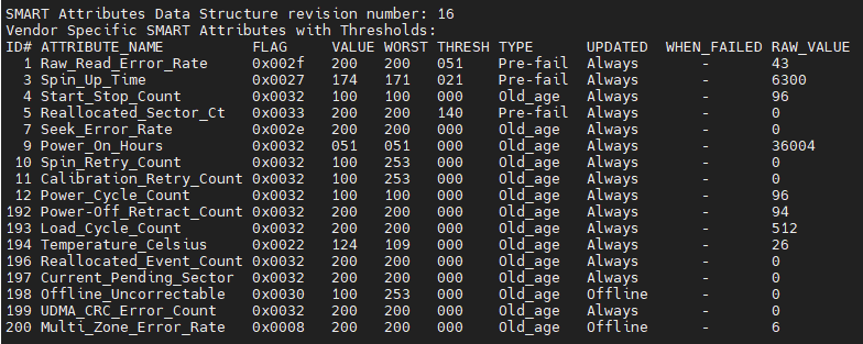

Older disk that was completely done by 36000hrs:

Jul 15, 2017
55
The 200 Multi_Zone_Error_Rate? I don't know if that's a permanent error. I'm not sure you could warranty on that with a single count. I'd run a extended SMART test and watch it for a count increase before getting too worried.
Multi_Zone_Error_Rate is a write error. It'll get cleaned up by ZFS, but any SMART errors are grounds for an RMA.
WD swapped it out without any fuss.
EDIT:
As was pointed out by allpurpbox in a post they have since deleted, a single error doesn't mean the disk is totally done. I should have clarified that this particular disk went on to subsequently experience further errors over next few days. However, I only have this single screenshot of the SMART output for that disk.
That said though, any consistently increasing error counts means a drive is unreliable and done in my book. I don't wait for heads to crash into platters or bearings to completely go before I consider a disk as failed. If it consistently errors during read/write operations then it isn't doing the job it's supposed to and it needs to go.
