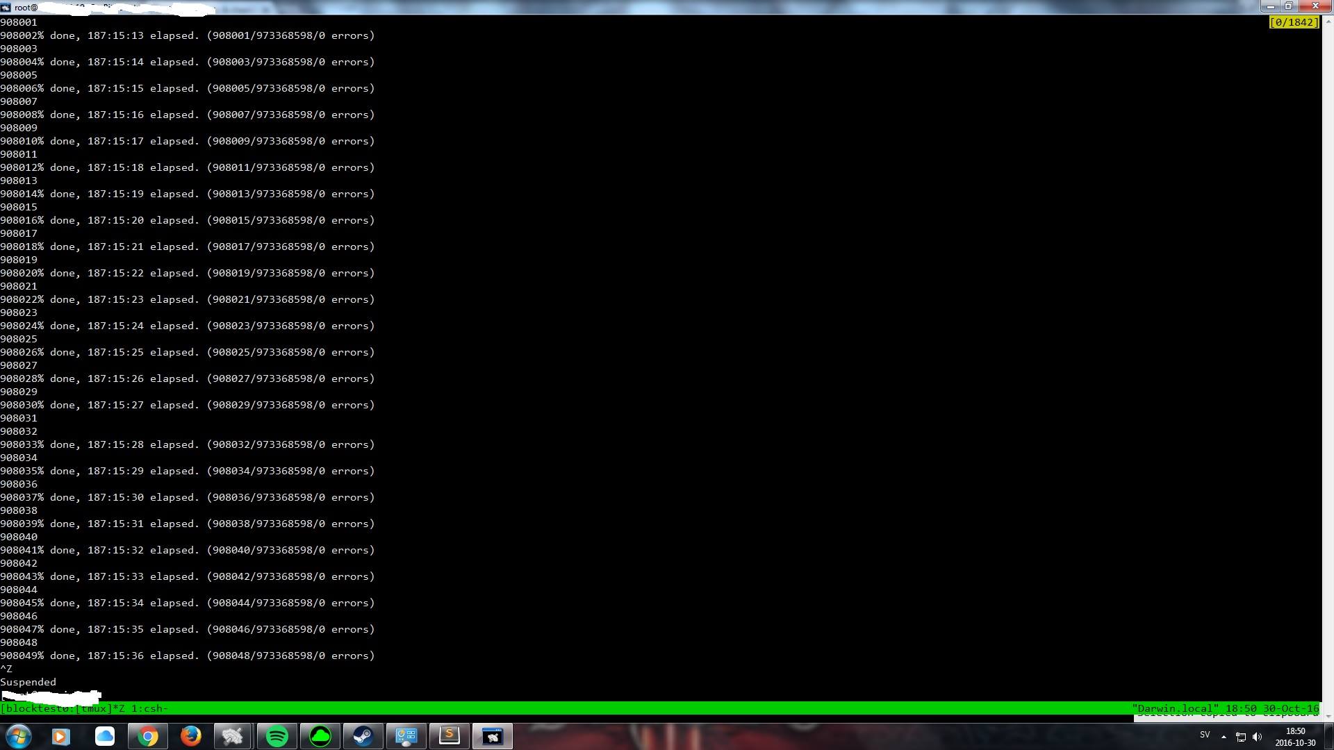

I am in the middle of my harddrive burn-in process. I did not notice it at first but in the dev list, all drives are listed with passX, daX save for the bootdrive wich is the only drive connected via the chipset SATA ports (the rest are connected via LSI3008 SAS controller with P12 IT-firmware) and da5 which also has this reverse order.
[root@Darwin] ~# tmxo show-buffer
tmxo: Command not found.
[root@Darwin] ~# tmux show-buffer
root@Darwin] ~# camcontrol devlist
<ATA WDC WD40EFRX-68W 0A82>		at scbus0 target 0 lun 0 (pass0,da0)
<ATA WDC WD40EFRX-68W 0A82>		at scbus0 target 1 lun 0 (pass1,da1)
<ATA WDC WD40EFRX-68W 0A82>		at scbus0 target 2 lun 0 (pass2,da2)
<ATA WDC WD40EFRX-68W 0A82>		at scbus0 target 3 lun 0 (pass3,da3)
<ATA WDC WD40EFRX-68W 0A82>		at scbus0 target 4 lun 0 (pass4,da4)
<ATA WDC WD40EFRX-68W 0A82>		at scbus0 target 5 lun 0 (da5,pass5)
<ATA WDC WD40EFRX-68W 0A82>		at scbus0 target 6 lun 0 (pass6,da6)
<ATA WDC WD40EFRX-68W 0A82>		at scbus0 target 7 lun 0 (pass7,da7)
<Corsair CSSD-F90GB2 2.0>		  at scbus2 target 0 lun 0 (ada0,pass8)
The smart test for da5 returned the following message:
Device: /dev/da5 [SAT], Self-Test Log error count increased from 0 to 1
This naturally made me suspicious, but I thought I would run all the tests on the other drives before I RMA:ed it, so I started badblocks testing.
As I half expected da5 started showing ridiculous amounts of errors. The test has now been going on for about 120 houers (been running more tests than I have threads so I expect it to take a while) All WDRED drives except for da5 are so far without error which is pleasing. However, I also received the following output from FreeNas email smartservices (I think?)
http://pastebin.com/aSa6YFWf
Since I am abit of a novice on these things I have the following questions:
1. Is there any reason why da5 (and the bootdrive) have their devicename and their pass listed in reversed order? Does it mean anything of significance?
2. Does the pastbin output log indicate that the error could be outside the drive? (E.g the SAS-controller)? Seems unlikely since all the other drives seem to be working.

2) ID 200 Multi-Zone Errors very well can be the indication of a failure however generally not a failure of a SMART test. My question is: What testing were you running for your Burn-In testing in which generated the errors? Bad Blocks or maybe "dd" ?
So far, I have been running short and long smarttests, badlocks, and long smart tests again. If memory serves, Da5 started acting up during the first long smart, and seemingly went haywire during the badblocks. See image for a snipet of what it was like.

:oops: You got troubles.
That has been running for 7 days on a 4TB drive?
Looking at the SMART information, you have grounds to RMA the drive. If possible you might be able to return to where you purchased for a new drive. Either way the drive is bad and nothing you can do will fix it.
I'll explain it a little... The SMART Long test failed at 90% into the read. This is a completely self contained test meaning your SATA cable and interface has nothing to do with the test other than to tell the drive to start and then you read the results. So the drive is really not worth putting any extra time into. Sorry for the bad news.
EDIT: The rest of your drives look to be in good working condition.

No bad news really. Better to catch it now then when the pool is up and running. Thanks @joeschmuck @danb35 and @Dice :)
I had that feeling fairly early on from the badblocks already, so I have already intitade RMA contacts. What worries me more is the failiure of da4 and da6 to read their smart error logs. Is that cause for concern?
