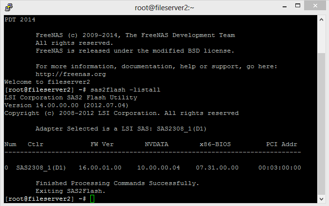

edit: i atteched output from sas2flash -listall

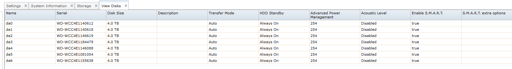

Disks info from Freenas UI, dmesg output, pciconf output, smart output is in uploaded file, because are too long.

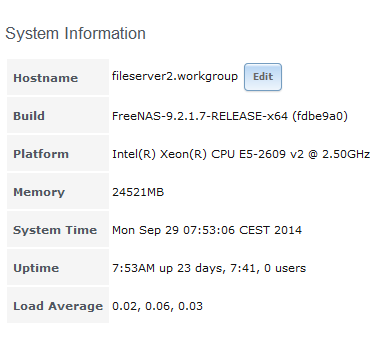

That particular log looks an awful lot like boot messages... Are you sure the system didn't reboot in the 24 hours before you received that email?
marian78
Jun 30, 2011
210
Hm, on server is not set periodic reboot, but i cant sit in front of server for 24/7 hours/days. How can i 100% check if it reboot? Some startup script in cron (like echo "reboot" >> /mnt/volume0/test/reboot_check.txt) ?
cyberjock
Inactive Account
Mar 25, 2012
19,525
The command "uptime" will tell you how long since the last bootup occurred.
marian78
Jun 30, 2011
210
Thx for all for your time. Server is up for 23 days.
