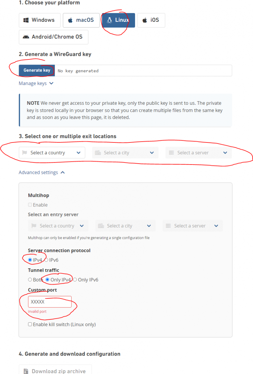

Get a Mullvad account and subscription
After you made your account on Mullvad and paid for some server time you can generate a configuration file for WireGuard.
Go to: https://mullvad.net/en/account/#/wireguard-config/
- I selected Linux
- Generate your key
- I selected a single country, city and server
- Opted for IPv4 only
- Left the custom port at default value that was filled in
- Download the configuration file
If you only selected a single server it should download a single plain text file, otherwise you will get an archive for each server. You need this later. Mine was very simple with this:
[Interface] PrivateKey = <private_key> Address = 10.xxx.xxx.xxx/32 DNS = 193.xxx.xxx.xxx [Peer] PublicKey = <public_key> AllowedIPs = 0.0.0.0/0 Endpoint = 193.xxx.xxx.xxx:xxxxx

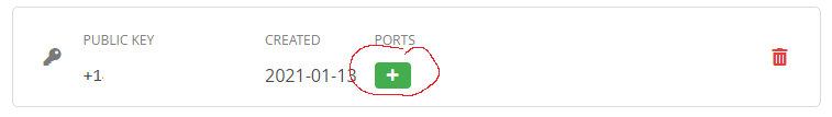

After downloading the file you need to generate a random port you can use for port forwarding.
Go to: https://mullvad.net/en/account/#/ports and click on the + icon next to your newly generated key to get a new random port. This is what we will configure in Transmission later

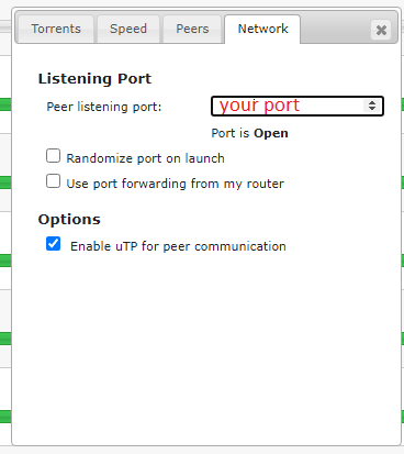

Start Transmission and configure the forwarded port
Start Transmission again
# service transmission start
Go to the Transmission Web UI and click on the wrench icon bottom left. Switch to the Network tab and enter the randomly forwarded port you got from Mullvad.
Alternatively you can change the port from the command line
transmission-remote -p <forwarded_port>
Or if you're using authorization for Transmission
transmission-remote --auth <user>:<password> -p <forwarded_port>
