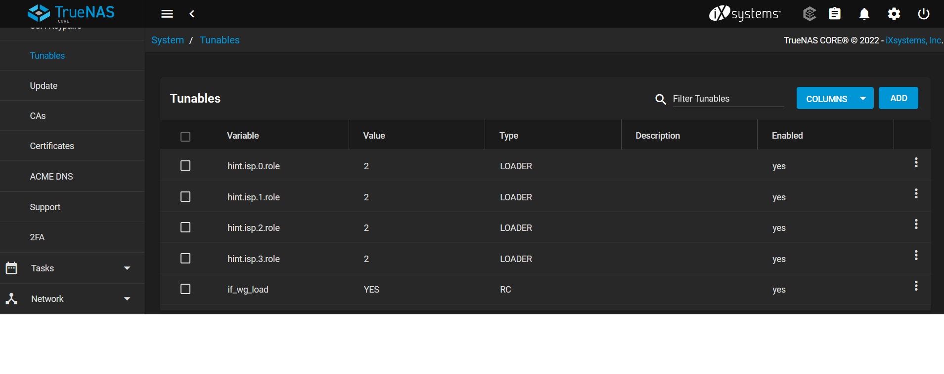

Hi I just updated to truenas 13 and all jails and I got problem to get wireguard working in jail with kenel support.
I turn on tunebales in freenas if_wg_load; YES , RC tried (I been using guide from this thread https://www.truenas.com/community/t...ion-jail-to-use-wireguard-with-mullvad.90232/) tried create new jail as well still not working.
And when i restarting wireguard service I got this as well after upgade I was using wireguard go for qbtorrent and I got dht nodes no prob now with new version Got connection and its show that is green but 0 dht nodes thats why I think i need to get it through kernel.

Please show the specific tunables you've configured.
On the host:
What does kldstat | grep if_wg show?
What does kldload if_wg do?
mmplpri
Apr 27, 2017
22
Hi thx for helping
kldstat | grep if_wg not showing if_wg loaded when i load it manualy with kldload if_wg working ok why it doesnt load up from tuneables on start then?;f
