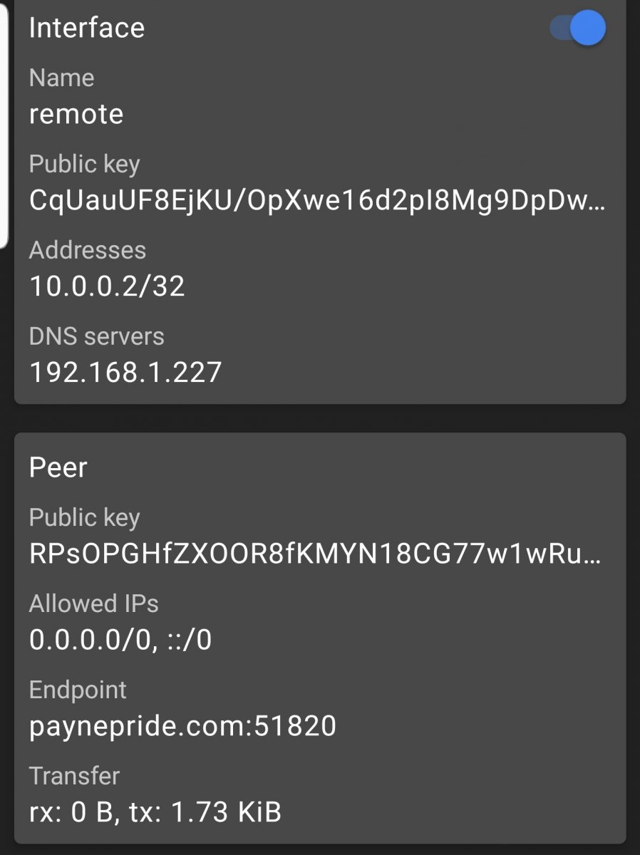

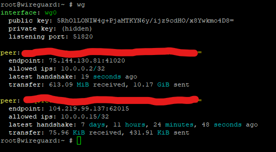

It looks like your clients have never connected. If you look at mine:
You'll see it has info on the last client that connected. Yours lacking info means the client never really completed the handshake procedure, so it never connected (even though the client says its connected, this is a massive shortcoming of all the official Wireguard clients: It shouldn't count as 'connected' until AFTER the handshake.) If you look at the log when you turn on the VPN on your client, what do you see?

The log repeats the message that it's initiating the handshake and eventually times out. So yes it's clear the client never connected and I agree that's a major shortcoming on the client application side.
I ended up getting the VPN server to work with client connectivity by changing by endpoint to the physical IP address of my router rather than using a domain name. I own a domain.com but when I use it as the endpoint the VPN breaks. I know the domain redirects right with regular applications as I have a few web pages that I host. Do you or anyone else have any idea why the DNS lookup is breaking there?

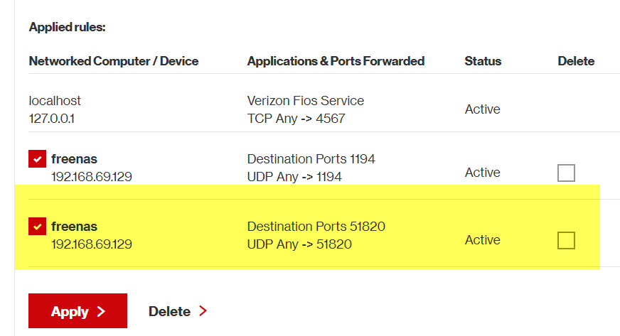

I am a little fuzzy on Port-forwarding parts.
port-forwarding for 192.x.x.x:51820 (local) <-->172.x.x.x/24 (jail)
Finally port-forwarding from WAN <---> 192.x.x.x:51820
This is what I have forwarded in my router but if I try and ping the wireguard jail it times out.
So, I am not sure I have this corrected and any help would be appreciated.

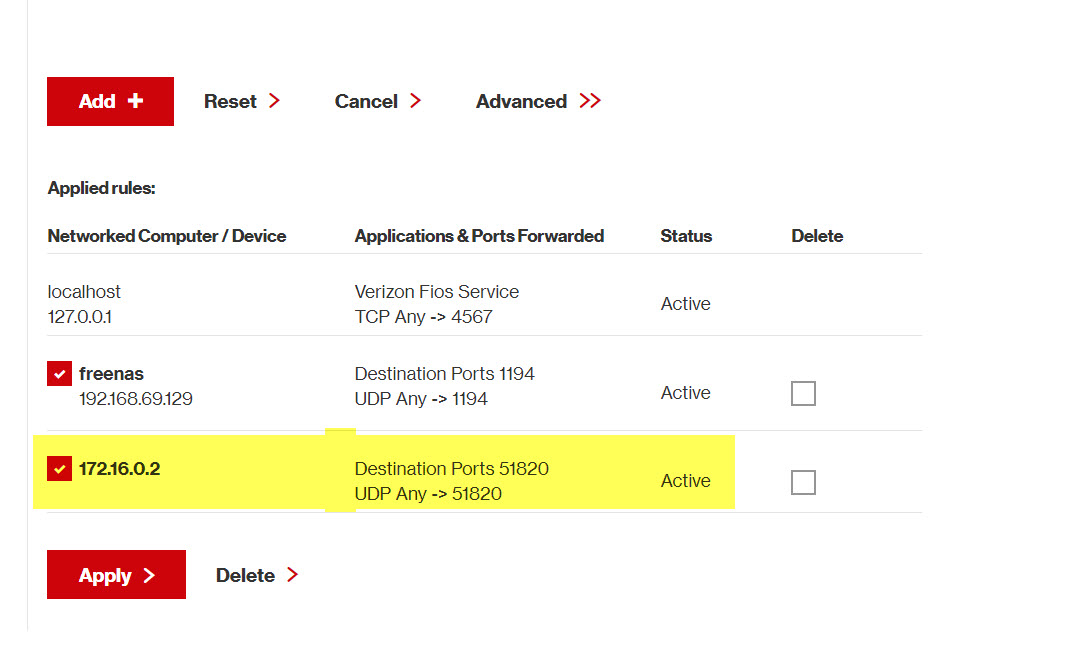

The forwarding is happening in two places
1. From your TrueNAS IP:port to the Jails (internal) port - Confirm you did correctly Step 1.c
2. From your Router port to TrueNas port - your NetworkComputer / Device is incorrect.
So on your router screenshot, rather than 172.16.0.2 you should edit the setting and replace it with 192.168.69.129.

So, updated the router:
When I type "wg show" I get the same where I can not see anyone connected
