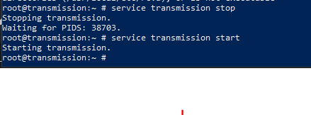

Current service start and stop for wireguard and transmission
