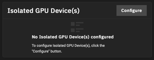

Regardless the failed nvidia-drm module, the Tesla P4 card is detected properly in @truecharts Plex app.

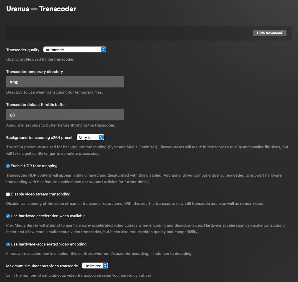

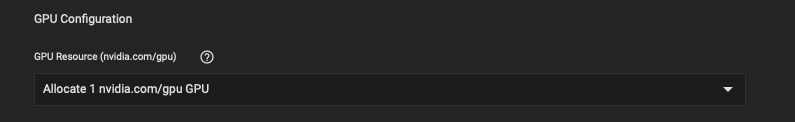

Can someone provide some guidance how to test the card is used in Plex for transcoding? I believe the easiest way is to check the dashboard.
Dashboard with transcoding disabled/forced, I can see the (hw):
Transcoder settings:

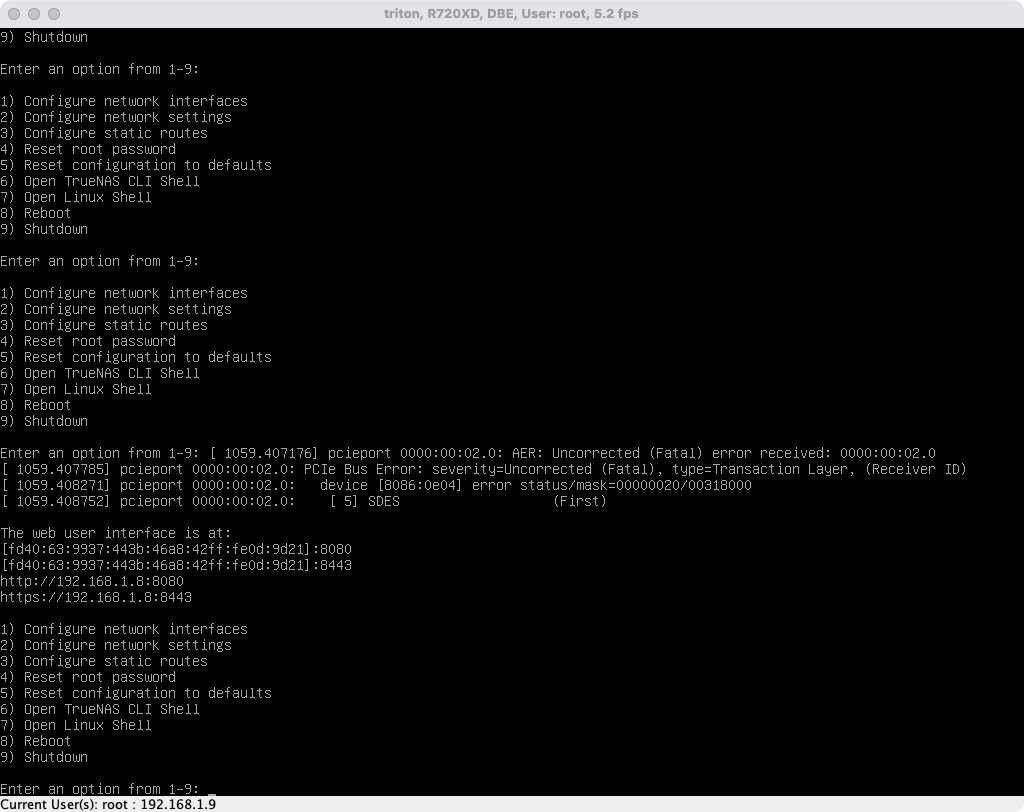

@eroji I got the crash again. Streaming stopped on @truecharts Plex, this is an issue that needs to be reported. How do I pull the crash dump, so I report it to IX into a Jira ticket?
Edit: I created NAS-119223, can you report you experience the same issue in Bluefin and submit a debug file into ticket?
Nov 30 19:24:21 uranus kernel: pcieport 0000:00:02.0: AER: Uncorrected (Fatal) error received: 0000:00:02.0
Nov 30 19:24:21 uranus kernel: nvidia 0000:03:00.0: AER: can't recover (no error_detected callback)
Nov 30 19:24:21 uranus kernel: NVRM: GPU at PCI:0000:03:00: GPU-ff5239ea-ba5d-4952-a55f-6ad0fc8f56bb
Nov 30 19:24:21 uranus kernel: NVRM: Xid (PCI:0000:03:00): 79, pid=0, GPU has fallen off the bus.
Nov 30 19:24:21 uranus kernel: NVRM: GPU 0000:03:00.0: GPU has fallen off the bus.
Nov 30 19:24:21 uranus kernel: NVRM: GPU 0000:03:00.0: GPU serial number is [removed].
Nov 30 19:24:21 uranus kernel: NVRM: A GPU crash dump has been created. If possible, please run
NVRM: nvidia-bug-report.sh as root to collect this data before
NVRM: the NVIDIA kernel module is unloaded.
Nov 30 19:24:22 uranus kernel: pcieport 0000:00:02.0: AER: Root Port link has been reset (0)
Nov 30 19:24:22 uranus kernel: pcieport 0000:00:02.0: AER: device recovery failed
