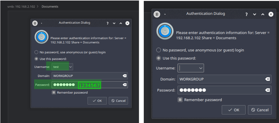

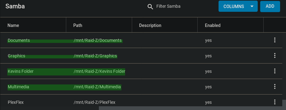

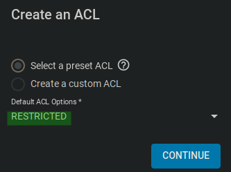

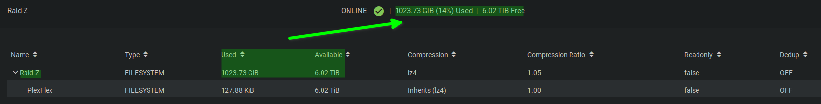

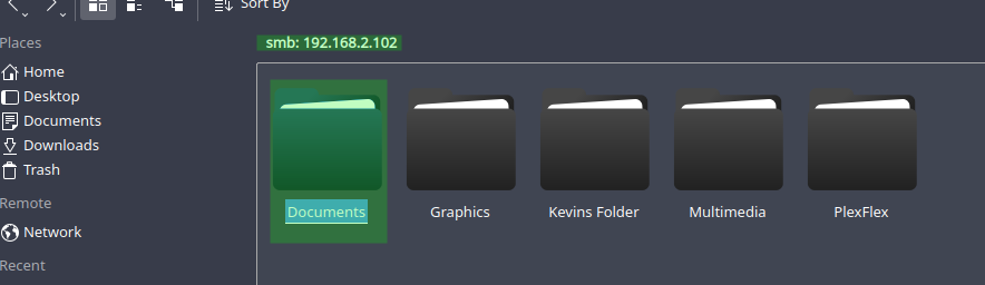

I hope this is the correct thread for me to reach out and ask for assistance. Ive watched many youtube videos in an attempt to get my SMB functioning again upon upgrading a working SMB system in 11.3 to a non working SMB system in 12.0. I figured screen shots would be the best way for me to show my set up in hopes that someone can see something out of place or incorrect in my set up.
System info: TrueNAS-12.0-RELEASE (previously upgraded from FreeNAS 11.3)
Storage Pool:
Accounts/Users:
Username: test
Password:1234567
Accounts/Groups:
Group Name: test
Sharing/ Samba:
Create an ACL:
Settings with ACL:
Operating System file manager: Testing out smb:\\192.168.2.102\ for the added Documents share folder.
The file browser see the shared SMB pools, but when I try to access folders and files inside with the user I created…...I get this…..It loops and does not let me into the share.

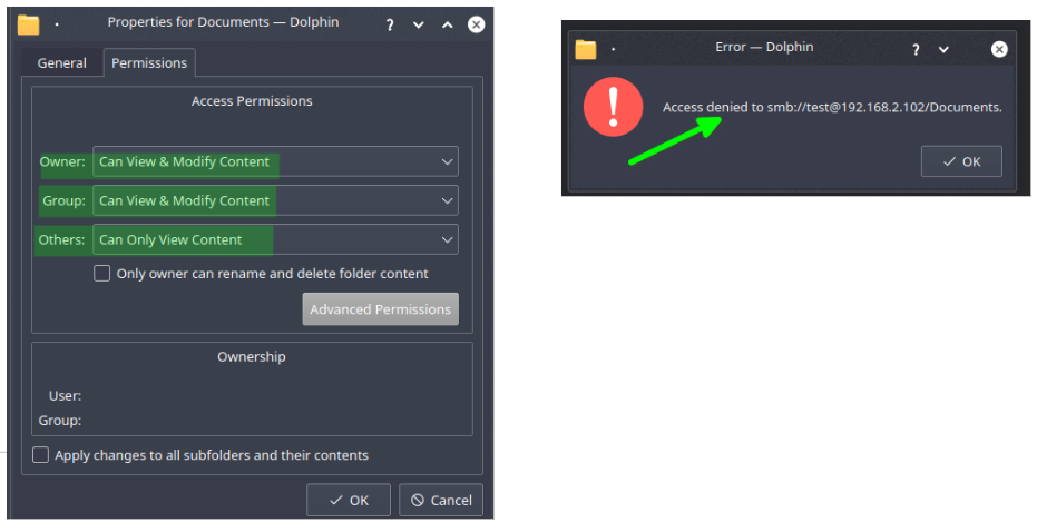

Whe3zy
Sep 4, 2020
21
When I view the Documents folder properties It wont let me mod any ownership to subfolders
