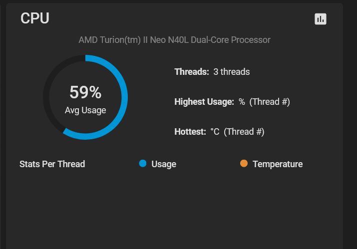

Hello,
I am having problems after updating freenas to truenas:
1) in the dashboard the percentage of CPU that is used remains fixed and does not change in real time, so it is only updated by updating the page.
2) Highest Usage and Hottest do not report data as shown in the screen below

Re your points 1 and 2 - this is a known problem to be fixed in next release - see this thread https://www.truenas.com/community/threads/cpu-stats-not-working-in-12-0-u4.93525/page-2#post-648347 for iinfo and a patch.

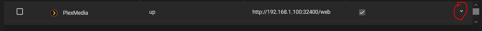

ah, I forgot. Another problem I found is when you go to plugins and expand a plugin (eg plex) the table with the data is no longer enlarged. The scroll bar is added, it is very inconvenient. I don't know if it is intended or a bug.

What do you recommend for the first two points? wait the official update? I read that it will be out in 6 days.
I suggest that you wait - the issue is only "cosmetic".

On the Plug in question - I don't use them and never have, just regular jails. But, maybe try the Columns function button to add some more and get the data you want? visible

I'm talking about any plugin, it doesn't expand the description. The columns button only allows you to show more columns.
