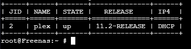

Can you show the output of iocage list?
Gimpymoo
Sep 10, 2018
39
Sure...
After rolling back the "working" 11.3.. I still get the file missing error when trying to force upgrade.
