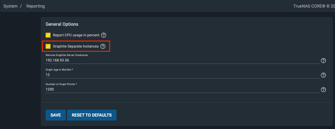

I updated rather early because I wanted this flag for my work on a nice Grafana dashboard:
Network, all VMs and jails running - no problem whatsoever. Subsequently I recreated all my jails and switched them from cloned to base jails for easier updates in the future. Jails are not yet entirely but should eventually be managed by Ansible alone.
SMB needed some fixes that @anodos was so kind to prioritise and roll out.
Since the BETA1: everything in perfect condition.
