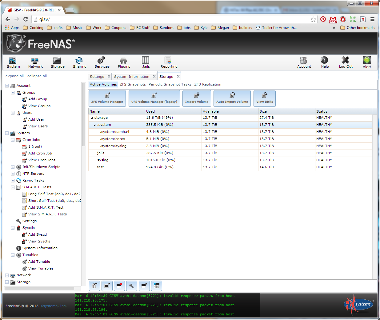

I previously upgraded to 9.2.1.1 where I had issues, then, I went back to 9.2. Upon returning to 9.2 I have a the new .system dataset showing up on my storage tab. I'm wondering if I should destroy the .system dataset created by 9.2.1.1 before upgrading to 9.2.1.2?
