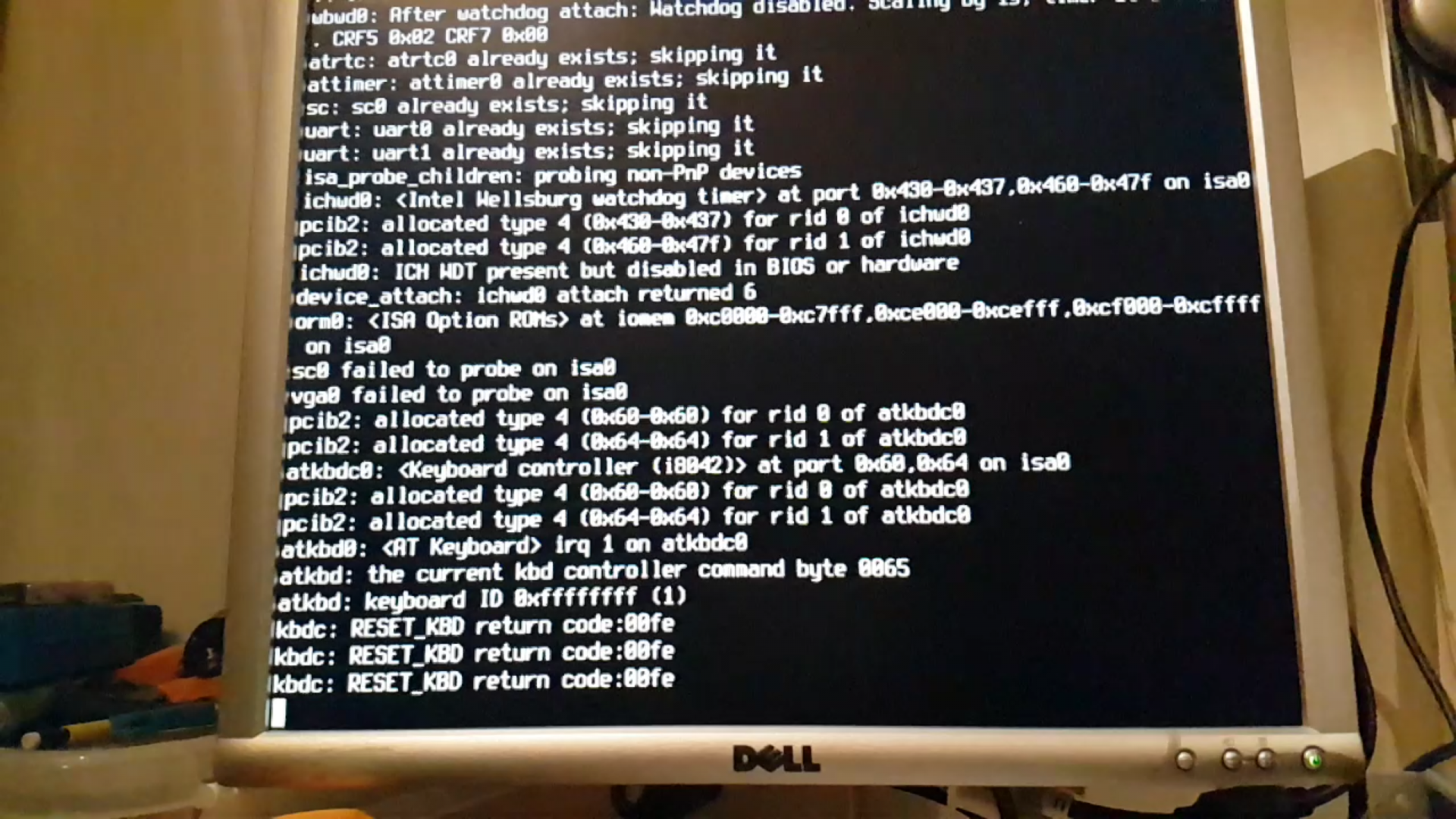

I have a problem installing FreeNAS on my new machine:
1x Asus Z10PE-D16 WS
2x Intel Xeon E5-2683 v3 2.0Ghz 14Core
1x Crucial DDR4 PC19200/2400MHz ECC Reg CL17 4x8GB
2x LSI MegaRAID SAS 9217-8i
The installer hits a point on the load up screen where it just reboots.
I've now spent days of trying to read and find out why but with no success.
The problem occurs on both FreeNAS 9.10.1 and the latest version of FreeNAS 10,
however both Windows, Linux and even FreeBSD 10.3 works fine.
Have also tried different bios settings and different install media USB and CD but the problem still remains.
I attached a picture of the last message show before restart.
Any help to solve this problem would be appreciated!

Have you tried booting without the HBAs installed?
You should try minimizing the hardware. Just the boot USB, no PCI cards. No network cards. One stick of ram. Etc. no HDs etc.

Thanks for the tip that was actually one of the first things I tried, but the problem still exists.
The strange thing is that FreeBSD 10.3 works with no problem so I don't see why FreeNAS would not work.
Have never seen this problem before :S

1.I disable CSM in asus motherboard bios setting,
and no more reboot,
stopped at atkbd0: <AT keyboard> irq 1 on atkbdc0.
2.then i found this:
https://twbsd.org/forum/1/551
https://bugs.freebsd.org/bugzilla/show_bug.cgi?id=180862
that said:
When he installed the FreeBSD,
FreeBSD-9.1-RELEASE-amd64-dvd1.iso didn't support AT keyboard.
FreeBSD-9.1-RELEASE-i386-dvd1.iso support AT keyboard.
3.remove all my keyboard and mouse, still stopped at
atkbdc0: <Keyboard controller (i8042)> at port 0x60 0x64 on isa0
hope probleam is here....

aha so now the installer stops at the same place as it rebooted before?
