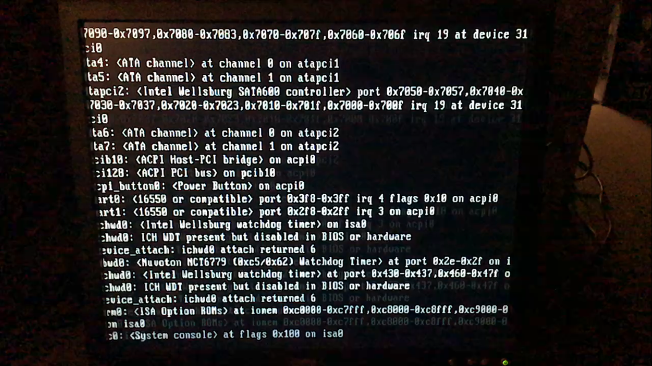

Id like to start by thanking for any help you can give and apologise if i've asked this in the wrong place.
I currently run freenas 9.3 with now no issues (well took lots of reading and learning)
I've tried to update to 9.10. I can successfully update but when it tries to start i hit issues. The machine hits a point on the black load up screen where it just reboots. I've now spent days of trying to read and find out why but with no success. I've Attached a picture from just where it then reboots. Also uploaded a video of it on to youtube so you can see in slow motion from boot to rebooting. https://youtu.be/kTo40fb8atM
I've tried fresh copies. Also tried different storage devices for the os.

joeschmuck
Old Man
May 28, 2011
10,996
I would recommend you grab a USB 2.0 flash drive (just a single one) and remove your pair of SanDisk USB drives. Install a clean copy of 9.10 to the drive and see if the system boots up okay. If it fails then I'd write a bug report. If it boots fine, I'd then reboot and verify things are good. If that works then I'd upload your configuration file and reboot. Hopefully it will work. Sometimes an upgrade will not work and it could be the USB flash drives. SanDisk USB 3.0 items are not good to have. Just my opinion.

I have the same problem. All updates applied correctly and when you boot from the new kernel , the server reboots without displaying any error. It does not generate any crash report . If I use the latest kernel version 9.3, it works correctly.

Can I ask the question. If freenas 9.10 can't attach the watchdog would this send it to fail and reboot?

I have the same Issue on Asus Z10PE-D16 WS running Freenas 9.3.1 since a while (rock solid). The upgrade run smooth until reboot shortly. After reboot a reboot for ever cycle is engaged. No way to see what is going on. A fresh installation have the same issue. After short install the machine reboot (believe the same spot) and then reboot for ever. The machine boot from a Kingston SSD 50 enterprise class disk.
