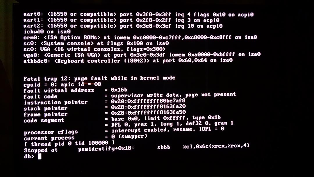

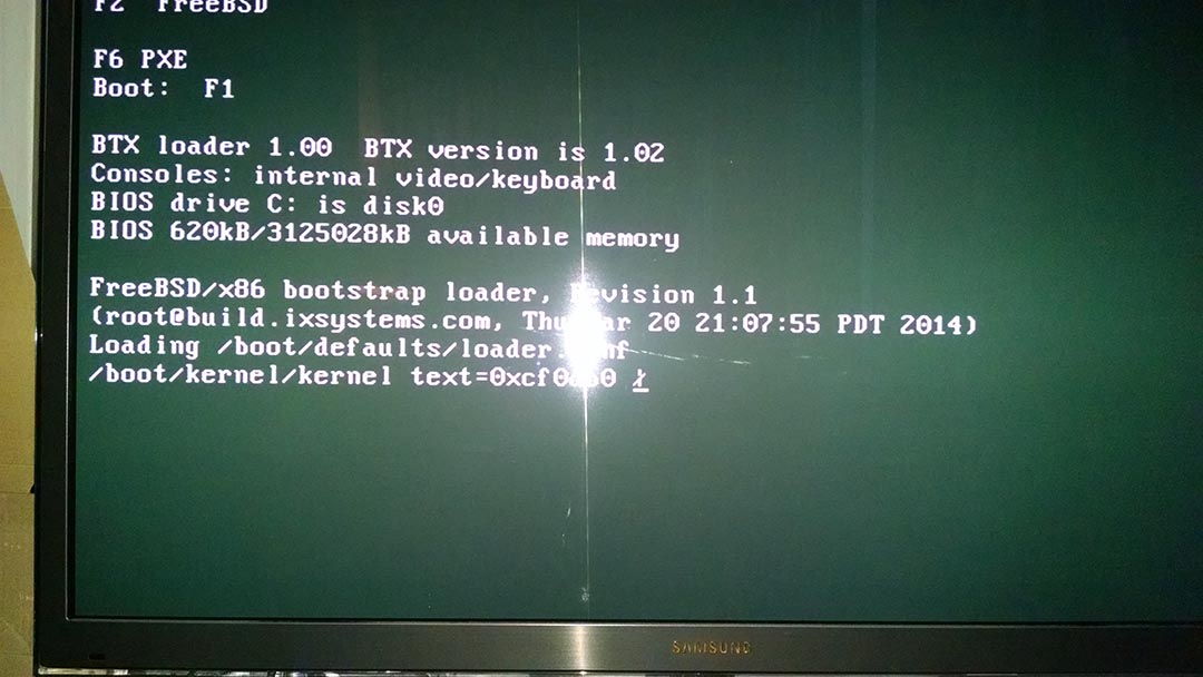

Anyway, here a couple of pictures. The first on is where it says "BIOS 640KB/3125028KB available memory." Idk if that's normal or not. (Sorry I didn't have time to turn off the flash for the first one.)
The second picture is my error message. Any thoughts?

ewhac
Aug 20, 2013
177
Just for laughs: Do you have a keyboard plugged in and, if so, is it a PS/2 type? (psmidentify() refers to the legacy PS/2 keyboard/mouse interface.)
EvanVanVan
Feb 1, 2014
211
I did have a keyboard, USB though. I probably used it to reboot and never unplugged it. LOL. I hope it's that easy, it did just boot up when I used a new USB stick. I'll try the old stick and no keyboard.
15,504
I think the 640/3125028 is pretty much normal--low vs. high memory and all. I'm more concerned that it seems to be reporting a total of only about 3 GB.
