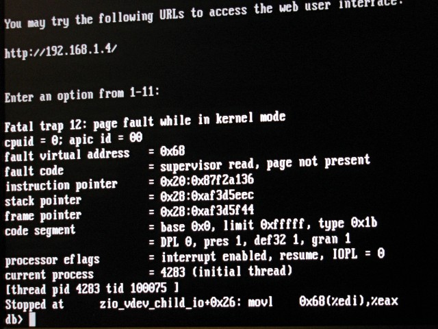

I had FreeNAS 8.3.0 installed running fine, pool healthy. I started copying some files over windows share, when the system crashed. After hard reboot, I got the "Fatal Trap 12" error, unable to access GUI or shell. I had a suspicion that bad SATA cables might have caused an HDD to be dropped from system, so I changed the cables. I reinstalled FreeNAS. Was able to boot, get GUI, setup SSH, but any attempt to import the pool, causes the "Fatal Trap 12" error.
Fatal trap 12: page fault while in kernel mode
cpuid = 0; apic id = 00
fault virtual address = 0x3c
fault code = supervisor read, page not present
instruction pointer = 0x20:0x81055156
stack pointer = 0x28:0x873d719c
frame pointer = 0x28:0x873d719c
code segment = base 0x0, limit 0xfffff, type 0x1b
= DPL 0, pres 1, def32 1, gran 1
processor eflags = interrupt enabled, resume, IOPL = 0
current process = 0 (system_taskq_1)
The drives & the pool is recognized when I do "zpool import" but if I "zpool import -f tank" crash.

I tried booting off a USB stick with FreeBSD 9.1 LiveCD, same problem: attempt to import pool caused "Fatal Trap 12". I even connected the HDDs to a different system, same error with trying to import.
Any help you guys can give me will be greatly appreciated. The data is extremely valuable to me, no backups (I know, I feel incredibly stupid), as I was in the process of ordering an external backup solution when all this occurred. I love FreeNAS, love ZFS, but this has me really concerned...
Thank you all for you time, patience, and efforts.

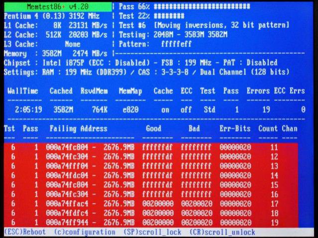

So, I've been running Memtest86 for couple of hours now - starting to get this sinking feeling as many errors are being reported...
Memtest86_001.jpg Since it looks like the memory is bad, I'll be working to save my pool on a different system. How should I proceed? Suggestions, since even a different system gives "Fatal Trap 12"?
So it's starting to sound like what Noobsauce was mentioning with the other person having bad memory and causing his pool to become too corrupt to fix. It doesn't sound promising, but keep us posted and confirm stuff with us if you're not sure.

If you do not have another computer to use then if you can, remove a block of RAM and run MEMTest again. Try to get the failed memory out of there. Sure you will have less RAM but you might be able to get things working so you can backup any valuable data. If you have other RAM modules you could put in, that too and then MEMTest.

For now, I'm in the process of Memtest86'ing each memory module to isolate the bad ones. A little later I'll try the import commands on a different system. Keep you guys updated, I'm desperately praying my pool can still be saved. I have so much valuable data on it. Thank you all for your quick responses, ideas, and help. :)

From 4 of the 1GB RAM sticks, one was really bad. So now running memory at 3GB RAM, did a fresh install of FreeNAS v8.3.0, followed by a GUI upgrade to p1. Rebooted, from the shell: zpool import
