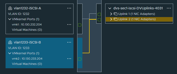

Separate-subnet design is correct for TrueNAS, but are you using the explicit VMware "vmkernel port binding" in this setup? That's intended for single-subnet design and shouldn't be used with TrueNAS - but if you've just assigned a single vmnic to each network (and/or explicitly set the failover order for the VM networks) then that's different.
Additional questions to "are you using VMkernel port binding?"
- Are you separating by VLAN as well?
- Do you have an SATP claim rule set up for the devices? If so, can you show me that (esxcli storage nmp satp rule list) - if you haven't, can you show a screencap in vCenter for the rules and ensure they're consistent across all hosts?
Sorry I'm not using the"Network Port Binding" option on the software iscsi adapter. I modified the failover order, sorry should have been more clear.
I do not have a claimrule set, but we're using host profiles for all 3 nodes in the impacted cluster, so they're all compliant and configured the same. End result is the same IMO, but I can configure a claimrule if that's the cause.

Good to know that vmkernel port binding isn't in play; it looks like you've got everything sorted, and using Host Profiles (and a dvSwitch) will keep things consistent across your cluster. Your pathing is correct as far as it defaulting to SATP_AA rather than ALUA (that's showing up with Cobia)
