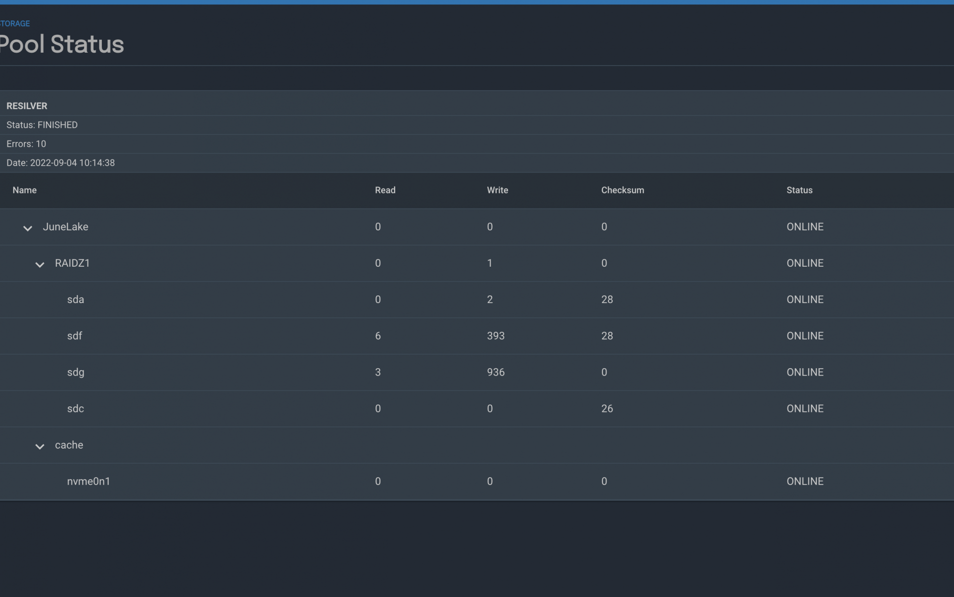

and the pool status looks like this:

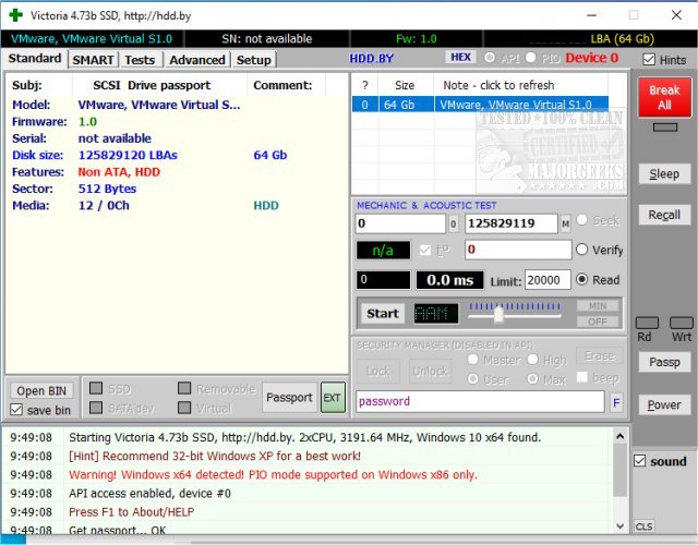

I haven't had to do this directly myself. But, someone else recommended this for a similar situation the other day:
