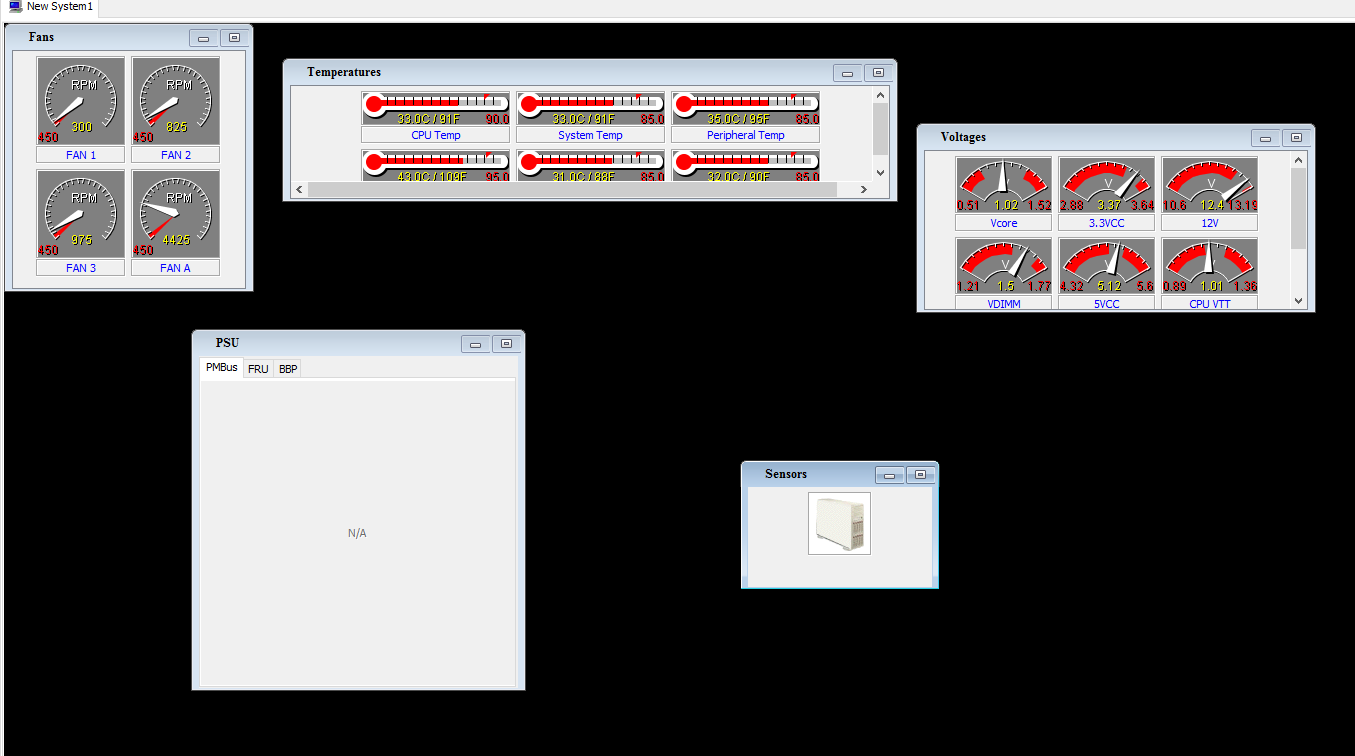

I'm not sure about those voltage readings, even if there is a lots decimal they still seem a bit odd. The first reading I would have expected to be something like 12.xx VDC. But they are all green. While it's not required, you might want to do a search on ESXi and your specific motherboard to see if the readings are as expected. Also, ensure you have the most current BIOS and BMC firmware.

I verified that there are correct readings on the board, and that ESXi is just displaying them incorrectly. Here is directly from the IPMI sensors page.
