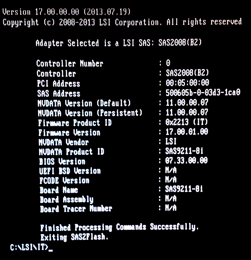

Well, I'm still back to what I said earlier..
I've cross-flashed it to M1015 (or LSI9211) IT mode; The controller now says the firmware version is 2.130.394-2550.
That number is *nothing* like your standard LSI IT firmware that is used on the M1015. So I have no clue what you flashed it with (or think you flashed it with), but that firmware version doesn't exist in the IT land. AFAIK the oldest one is P7 (7.00.00.00).
So no clue what you are doing or what you think you are doing. My firmware version is 16.00.00.00, and that's not even the newest firmware out there!
That looks like a MegaRAID firmware (mfi) version number. It probably failed to flash or had some other misadventure that resulted in it not flashing correctly.

Please downgrade it to v16 of the firmware, to match the FreeNAS driver.
