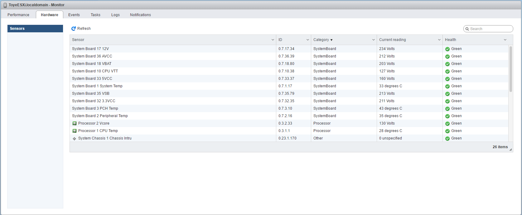

This is what i am looking at in ESXi. I don't think this is a freenas issue. Hardware maybe. Going a different drive as well as new cables.

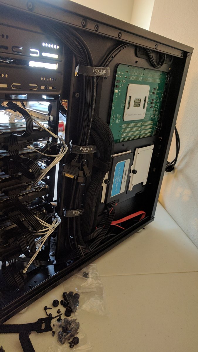

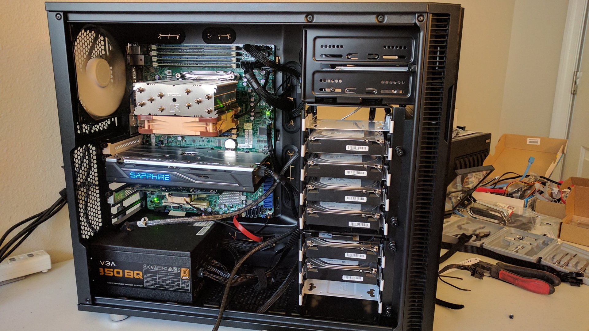

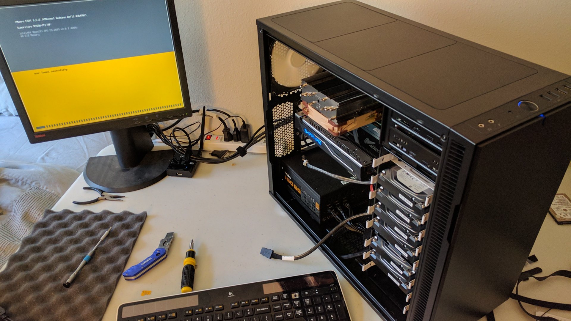

Current progress on installing the new board . already tested it out of the case and it runs like a charm. It has an onboard LSI adapter I would like to migrate to. There shouldn't be an issue with migrating to that in place of my m1015, assuming I can configure pass through of course. I'll be starting with my default config though , using the m1015 for troubleshooting purposes.

How do you like that keyboard? Looks interesting. Yea, I know I should be drooling over the computer but peripherals are cool too. I have always preferred wired keyboard and mice but willing to make a change. My current keyboard is a mechanical key version. It's nice enough.

That one is a Logitech k750 that I have had for 6 years I think. I just cant find one I like more. The extremely slim and flat keys makes it awesome for anything coding wise or just typing in general. Never had an issue and the best part is, its solar, so I have never changed the batteries.
Edit: they still sell this keyboard, for obvious reasons. Its awesome.
I did just purchase a k800 I think it is..to see how it compares , but again, the keys are much bigger and you need to press them further (that sounds stupid, but I'm sure you know what I mean). It does have a fancy backlight to the keys that is motion sensored, and of course, its rechargeable.
