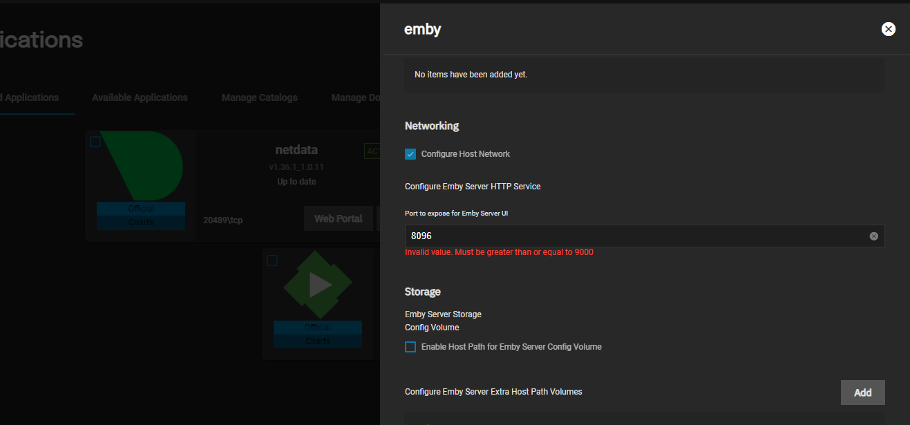

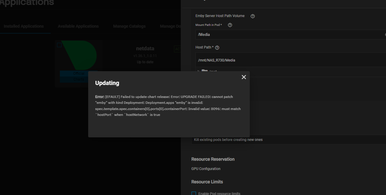

Hello! I dont know, but i cant find any solved threads with that problem. Truenas Scale -> Emby App installed. And DLNA wont work.
And another nice moment. Can you say me please, how i need to beat this xDD -
