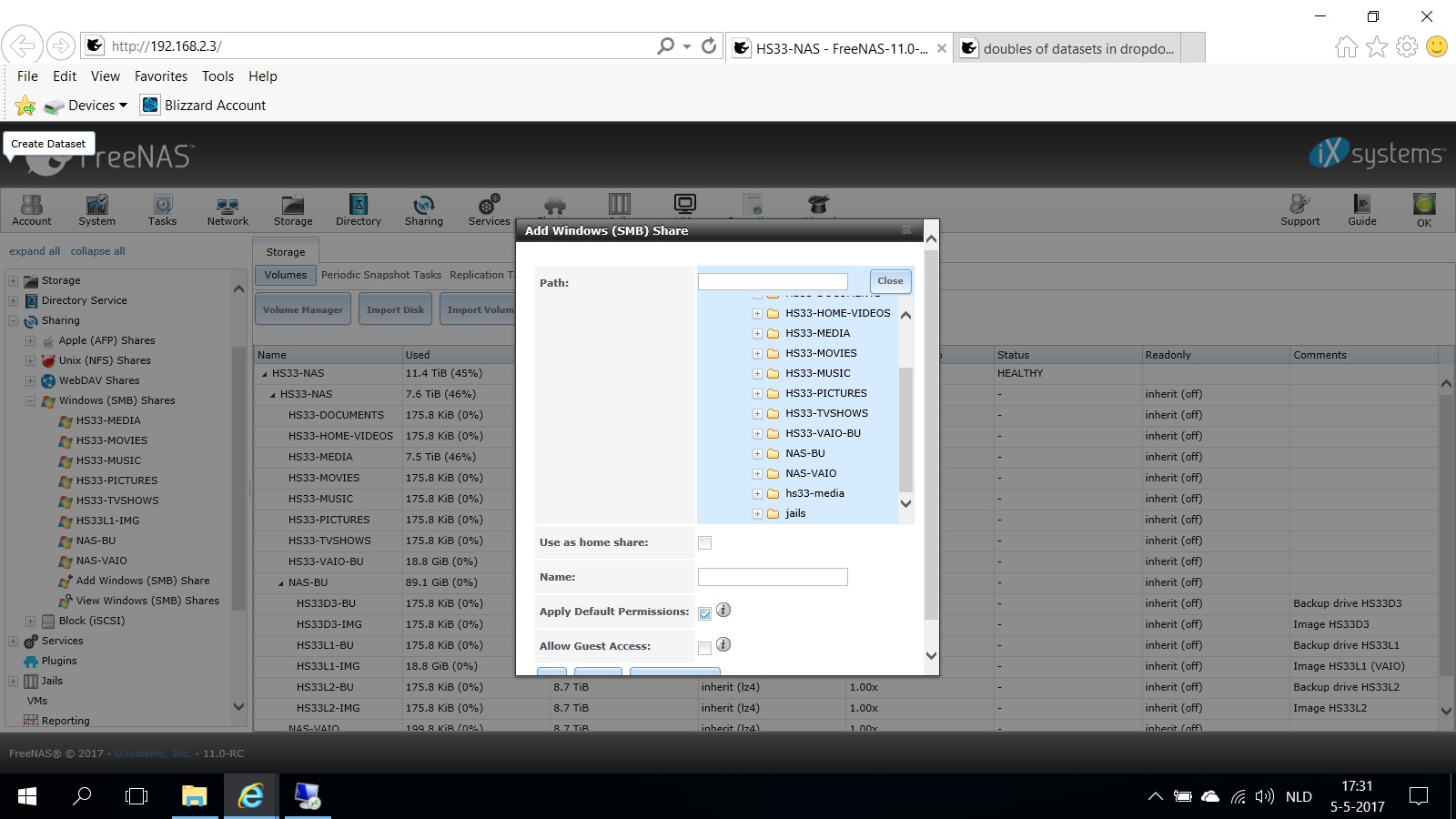

For some reason the dropdown menu's in the GUI show duplicates (in small letters) of a couple of my datasets. Earlier I had the problem that the files in my datasets wouldn't show (could map the drive, open the folder and just saw the json config file).

See the HS33-MEDIA dataset. It has a double hs33-media, which shouldn't exist. And the jails folder/dataset, shouldn't exist at all. it used to be a plugin dataset.

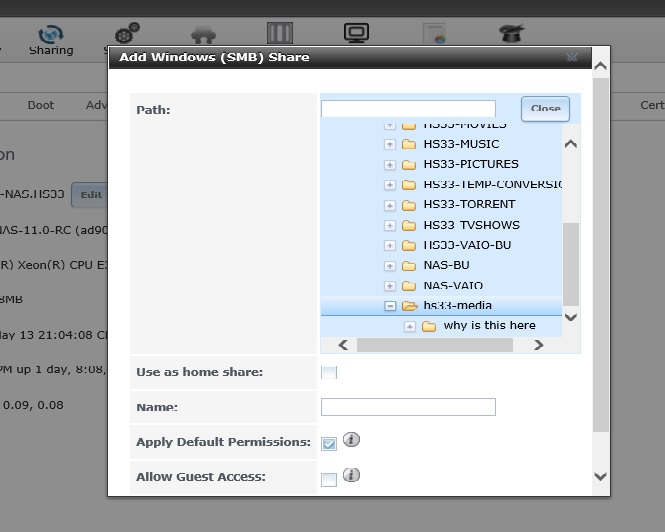

Mike77
Nov 15, 2014
193
I've added the new picture of the current situation.
As I wrote before, I was able to create a share with the non existant hs33-media, which I could access from my windows desktop. I added a directory named "why is this here". You can also see that in the drop down.
[EDIT] The strange thing is, that a fresh install of PLEX tried to access the hs33-media folder. But it couldn't.
So it isn't there for PLEX, but PLEX thinks it is.
It isn't in the zfs list (cli) or in storage (gui), but it can be a share, which does work....
[EDIT] BigDave just showed me that his v.11 install (which he says, has never had a Coral install) has the same .Boot2Docker and .vm, datasets. So at the moment there is no longer a direct reason to assume that those datasets and my problem with the not working Plugins and "Ghostly datasets" are related. Still strange that there are Boot2Docker files, while 11RC doesn't support Dockers...

Mike77
Nov 15, 2014
193
I just tried to add the dataset through the GUI. But that doesn't work, although it still doesn't show in zfs list:
