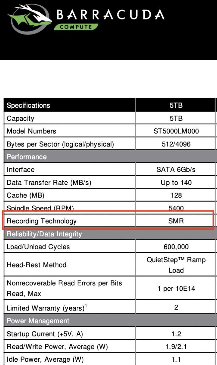

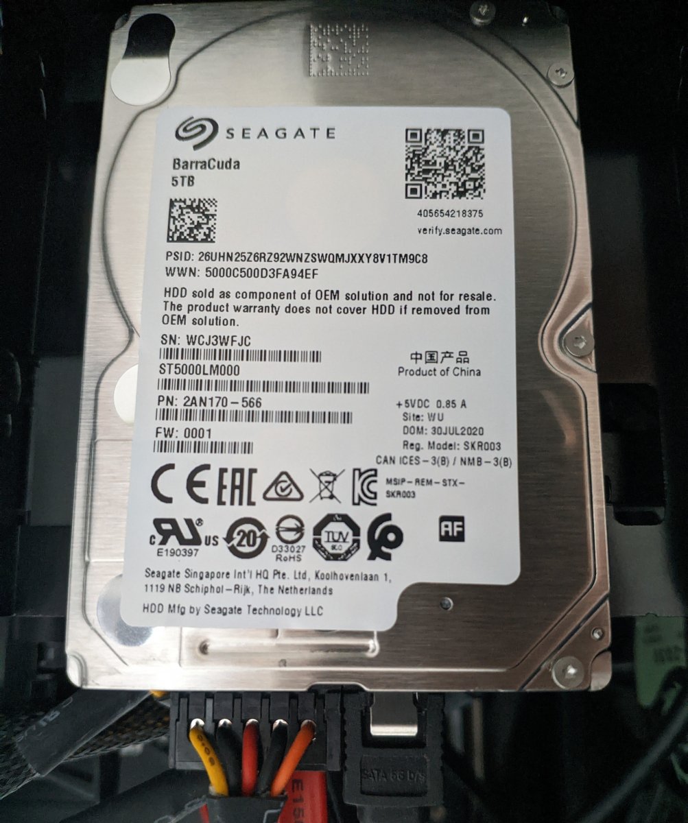

So - for company use and...........
Gamer gear, no ECC, SMR Drives, Not enough memory (although does acknowledge that), "cache" drive (SLOG) with incorrect spec drive (probably), NIC is a "Qualcomm® Atheros® AR8171" - I am unsure of support - but suspect there isn't any.
So far everything is wrong - we don't know about the PSU or case (which is unlikley to be a big problem)
Those SMR disks are absolutely no use to you - throw them out / use them as doorstops / return them if you can

Correct on the last line, but I'd like to draw your attention to the words "testing" "lab" and "I know my build is not right but I tried to test it as is" - OP is definitely aware that the hardware right now isn't "business grade" but wants to ID if the problem is their hardware or a config/TrueNAS choice.
We've ID'd the problem pretty quick as the drives @mrcbns - are they by any chance repurposed/previously used drives? And do you have any other drives that aren't SMR?
If you don't, you might get some performance back by fully erasing the 5TB SMR drives - and giving them enough time to "clean their shingles"

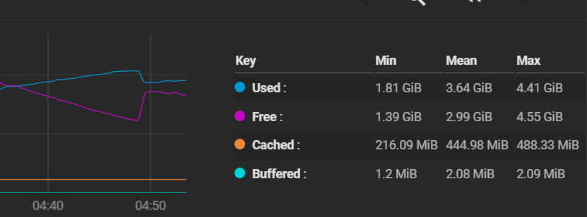

RAM pressure is not even as pushed like with HMR disks pool.

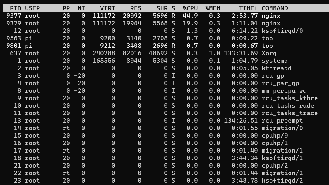

So I checked my reverse proxy which is proxing to my NAS and CPU is weirdly high in all the test I do while upoading random or sequential files as you can see.
TDLR:
although my main problem is the HMR disks, it seems that the main issue is my reverse prox.
What is your opinion?
What can I do to improve this situation? Should I move the reverse proxy to the NAS directly? Thanks!

I looks like Raspberry pi 4 HTTPS TLS performance is crap, because there is no hardware support for encription. I will try to run nginx on the NAS and check results.

Well, I just nailed it. I painfully managed to run docker-compose -> portainer with the help of Truecharts docs.
So after reproducing my reverse proxy with minio containers y got x10 times the amount of upload speed I was expeting for us.
Results compared speaks for thhemselves:
...LE-22.02.0.1.iso: 899.41 MiB / 1.50 GiB [===================================> ] 34.92 MiB/s
