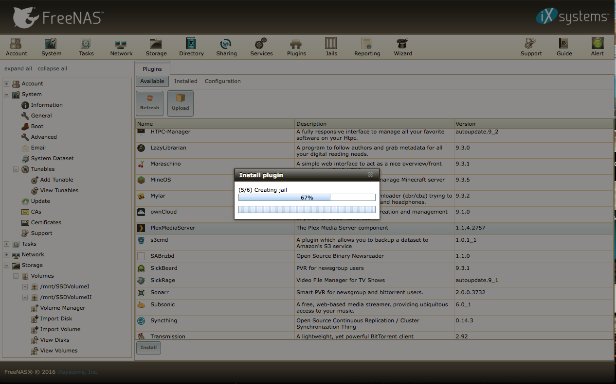

OK, so I removed the LSI and used the PERC H330 (configured as just an HBA non-raid). Everything was working great I.E. copying data, Volumes ETC. So I wanted to see what happened if I tried to install a plug-in. Selected Plex and it started the download blah blah and as soon as it started creating the jail, it shat it's self. Really would the controller cause that? I was copying data just fine 90mb/s +

Crash dumps -
If I read this right its crashing right when it starts creating the bridge/ifconfig on the lagg interface. Right Wrong or complete air ball?
I need to clarify a bit. I've been able to create a jail manually but not if a plugin is used IE Plex to create a jail. I haven't tried any other plugin's. Once it crashes it NEVER comes back and I have to rebuild the whole thing.
