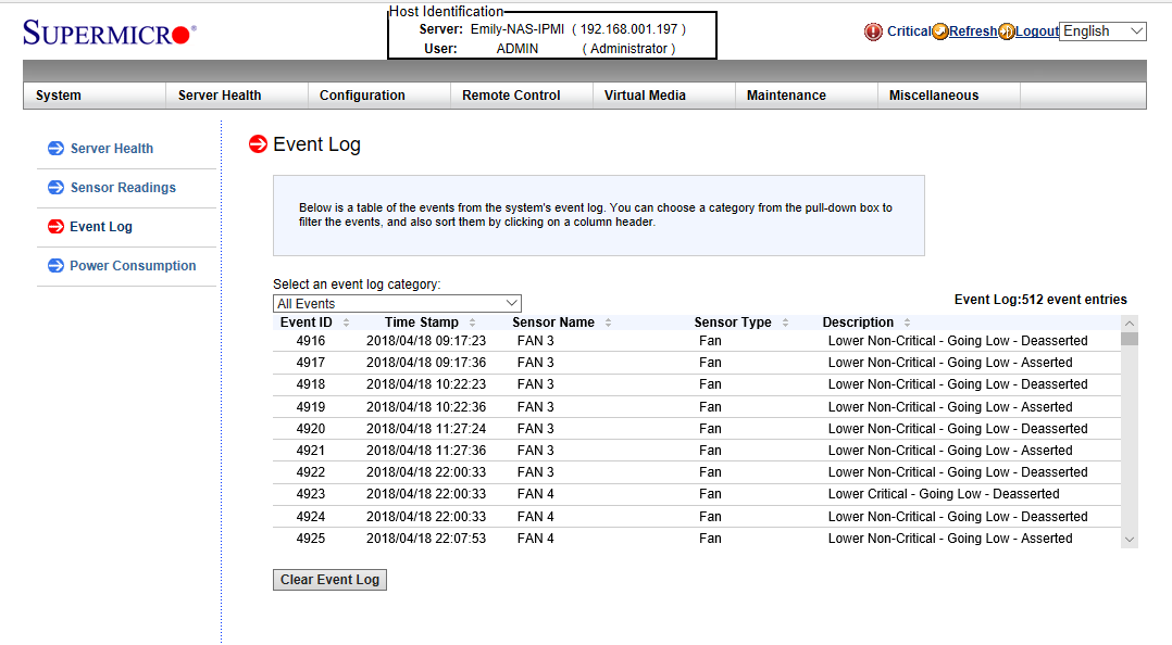

I didn't even know the BIOS does any logging, never heard of it. At least on consumer hardware.
That is one of the reasons that Supermicro server boards are so highly recomended on this site. They do logging and you don't even need to go into the BIOS to pull the log. The IPMI web interface allows remote management of almost everything including viewing the log like this:
