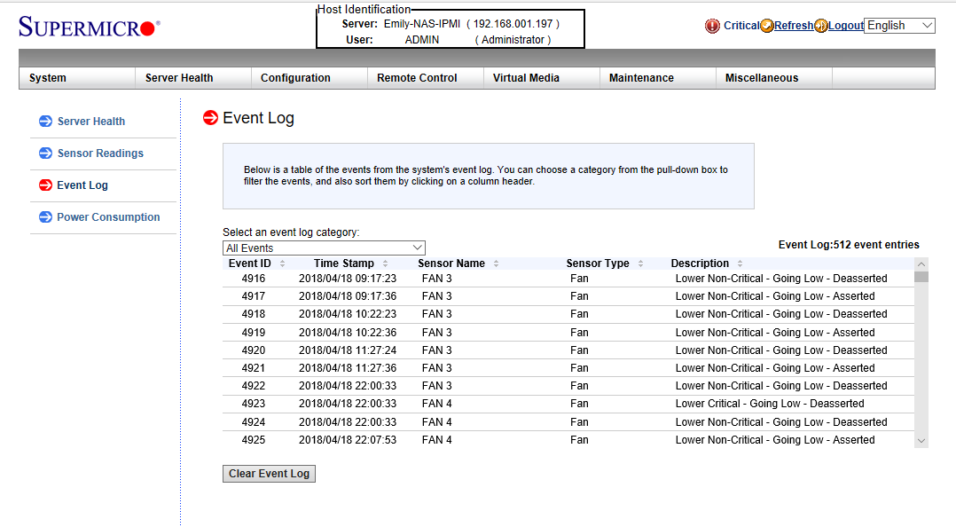

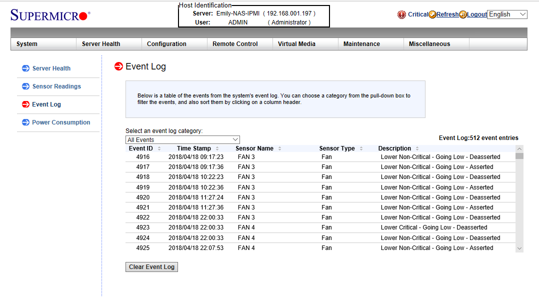

That is one of the reasons that Supermicro server boards are so highly recomended on this site. They do logging and you don't even need to go into the BIOS to pull the log. The IPMI web interface allows remote management of almost everything including viewing the log like this:
Hey Chris, if that’s from one of your systems, you know there’s a way to fix those errors right?
