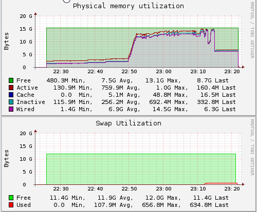

Well, I take back what I said about RAM...
I can't explain how a system with 16GB of RAM is swapping, but I watched the free memory dropping and dropping as I was doing transfers (which I expect as the cache fills). My assumption was that the cache would be sacrificed to give RAM to processes that needed it... but the processes associated with the iSCSI writes seemed to get starved for memory. The free RAM hit zero, and the system swapped... and then all was lost, and the system eventually dropped the network connection and had to be rebooted via IPMI.
Here is what the memory/swap looked like when I repeated the process again to confirm it:
I did some searching around the forum to see about ways to limit the cache size, but the consensus seems to be that it should do this automatically. vfs.zfs.arc_max is set reporting nearly 16GB. I've never set anything to manually manipulate this... what should it read on a system with 16GB of RAM?
