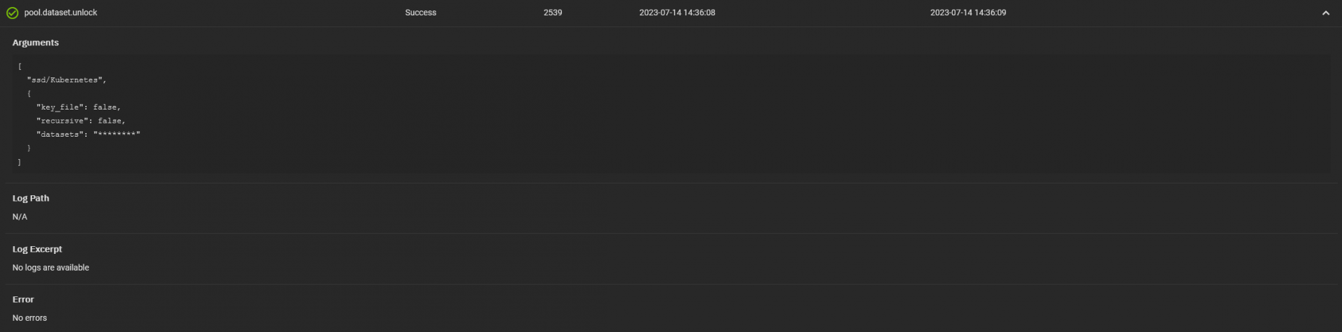

Hi, just tried that, but it just responds with some number (I assume a request counter?) and the dataset is still locked.
admin@truenas[~]$ midclt call pool.dataset.unlock storage-pool/Development '{ "key_file": false,"recursive": false,"datasets": [{"name" : "storage-pool/Development" , "passphrase" : "<some pass>"}]}'
2453
9,703
That's a Job.ID.
You should be able to see it with its status in the Jobs list (top right of the UI... picture of a clipboard/tasklist).
Sapp
Jul 13, 2023
10
That's a Job.ID.
Ah, got it. It doesn't indicate any errors, but as said not unlocked still.
You see that is says "success" though, right?
Are you absolutely sure (noting that the command you used was not recursive, so only that top-level dataset would be unlocked)?
9,703
At the very least, the lack of error there tells me the password you're using is still OK. (you can try with a deliberately incorrect one to see if it still reports success or not).
Also note: if the real status is unlocked, unlock may fail due to that.
Sapp
Jul 13, 2023
10
Yes, that's what is confusing me even more. It still does not show up though. Neither it is mounted (/mnt/ssd/Kubernetes is empty) nor it is shown in the GUI:
When repeatetly calling the unlock API call, it still succeedes.

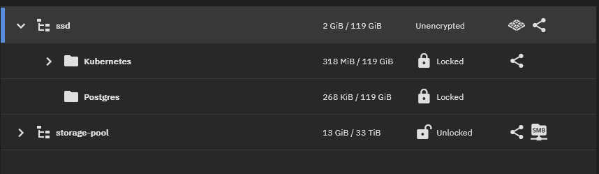

OK, so via the API, it seems to unlock... so can you open the next level of datasets and see if they are still locked?
Also does the command from @winnielinnie show it's unlocked?
zfs list -r -t filesystem -o name,encroot,encryption,keyformat,keylocation,keystatus storage-pool

What about the other commands? To get an overview of the layout and encryptionroot hierarchy.
Sure.
admin@truenas[~]$ sudo zfs list -r -t filesystem -o name,encroot,encryption,keyformat,keylocation,keystatus storage-pool
