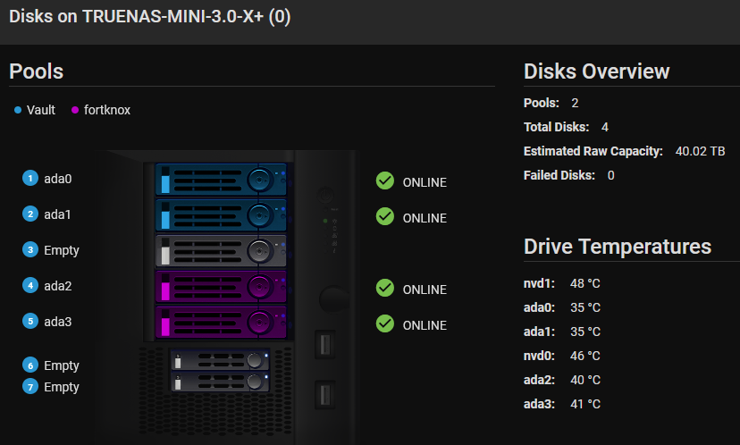

A display of drives-to-bays exists only for certain iX hardware. I'm not aware of a way to build a custom widget/page into the UI.
Ok, thanks for confirmation. It's a pity, but I think I will then stay with my current solution. Thanks!

@gaston.lu i can confirm that some IX Hardware have this functionality. I have a Truenas Mini X+ in my office that has it
However, i have a second system at home that is a DIY and doesn't have this.
It would be awesome to have this same functionality on DIY systems but as far as I know it is not possible.
Out of curiosity, which other solution are you trying that has this?
