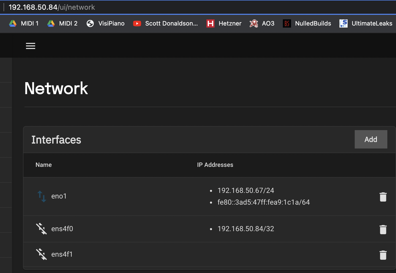

This is even crazier. Setting a static ip for the network works, but still no traffic if I remove the realtek:
How in the world is it connecting via 50.84 but without a link?
jgreco
Resident Grinch
May 29, 2011
18,680
You set up a /32 netmask.
Also you have two IP addresses on the same IPv4 network, that's not allowed. You should place your interfaces on two different IP networks, and the /32 is likely breaking things in unusual ways. I can't predict the exact results of the /32 on Linux. But please refer to
Apprisco
Aug 3, 2022
40
You set up a /32 netmask. Also you have two IP addresses on the same IPv4 network, that's not allowed. You should place your interfaces on two different IP networks, and the /32 is likely breaking things in unusual ways. I can't predict the exact results of the /32 on Linux. But please refer to
I've also tried 24. I remove the original link's ip address, but I can't connect to the 84 ip. My last hope is the linux driver meant for red hat, as I was able to unlock apt-get and install rpm without breaking the current truenas install, I will be giving this a go.
