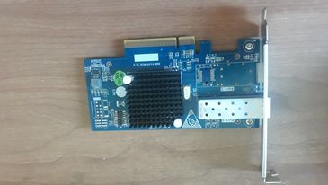

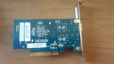

Here's where I bought it
But your right I don't see a Intel Yottamark on it

That's clearly not an Intel X520. Someone may have named it "X520" to confuse the issue, it might even attempt to be a knockoff of an Intel X520. I suggest returning it for a refund.
The Intel cards are green PCB with a bar across the bottom. Even those get faked. Legitimate Intel retail cards have a Yottamark that will pass validation, and are available used at a reasonable price. Last time I bought a round of X520-DA2's or -SR2's I think they were going for about $100-$125 each, and the single port -DA1 or -SR1's were about $75/each.

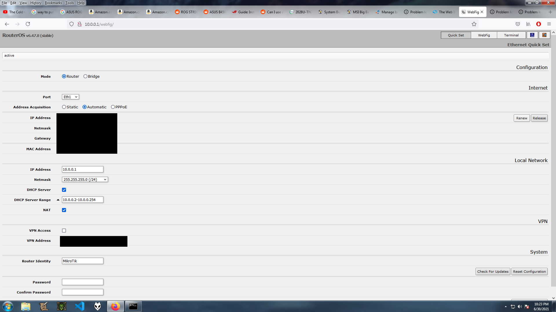

alright so I have
ip: 10.0.0.208
Gateway: 10.0.0.1
default: 10.0.0.1
still wont connect

Please post screenshot of Network>Global Configuration
Redcoat
Feb 18, 2014
2,922
I hope someone more knowledgeable on the basics of network addressing will be able to confirm that your
10.0.0.1 gateway and subnet mask of 255.255.255.0 are appropriate. I am only familiar with Class C.
