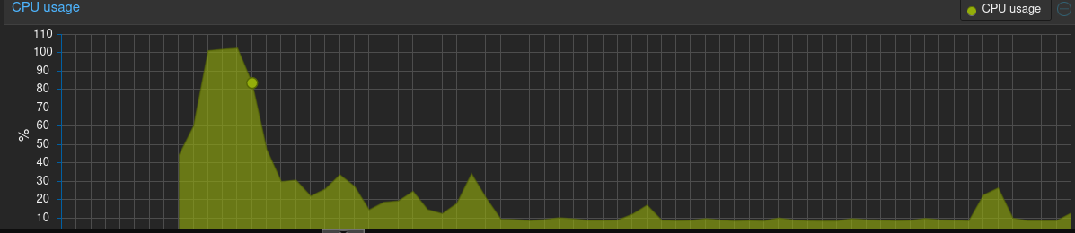

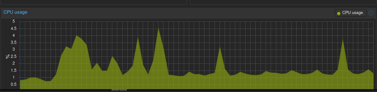

Finally, CORE VM idles at 0-1% for me while my SCALE VM idles as much as 10% for no reason. If I was on the fence on SCALE before, this seals the deal. BTW, I run SCALE only in experimental capacity, so this is not even hosting any real pool or users! It is only running a few apps like Nextcloud, Syncthing, etc that are doing nothing (not being used in any capacity, just idling).
I think these pictures speak for themselves, CORE graph upper limit is only 5%, averaging around 1%, while SCALE goes all the way to 100% and averages around 10%. It's not even remotely close. Also, the bugs are crazy. The spike to 110% in the beginning is some apps stuck at "deploying" forever and sucking up ghost CPU cycles for no reason. I deleted those apps and you can see the CPU usage dropping down in response, but still never really truly idling (bottoming out at 10%).
CORE:
SCALE:
