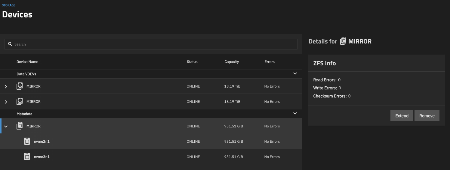

so my plan is to use my 2 x 1TB NVMEs (which atm are used for special metadata but i can remove them from the pool) [..]
Are you sure about that? IIRC a metadata vdev cannot be removed from the pool once it is there. I may be wrong here, but better safe than sorry.
It should be the same rule as for the "main" data vdev: Can remove if the pool is fully made of mirrors; cannot remove any vdev if raidz# is involved somewhere.
okay good haha, i was just googling around trying to see if it was possible, i think dodged a bullet using striped mirrors for my setup, i plan to upgrade to raidz2 soon but i need to buy 2 more drives, but yeah i think I'm done with the special metadata vdev, i haven't really seen the benefit since most of my data is videos and when i run vms /apps i use a nvme pool
Also worst case i have a 1x 10TB backup pool with my key data on it (the rest can be downloaded again), so I'd just have to wipe the pool and restore
KingKaido
Oct 23, 2022
23
i have the option to remove the metadata vdev, but tbh it could 'error' when you actually try remove it,
ill report back when i do the the big move to proxmox!
