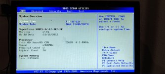

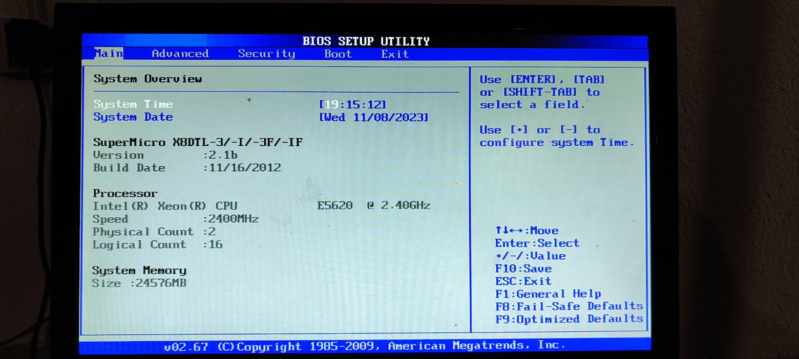

TreueNAS-13.0-U5.3
SuperMicro X8DTL-3
Processor (CPU) - 2 x Intel Xeon CPU E5620 @2.40GHz
Threads: 16
24 GB RAM
4 HD x 4TB

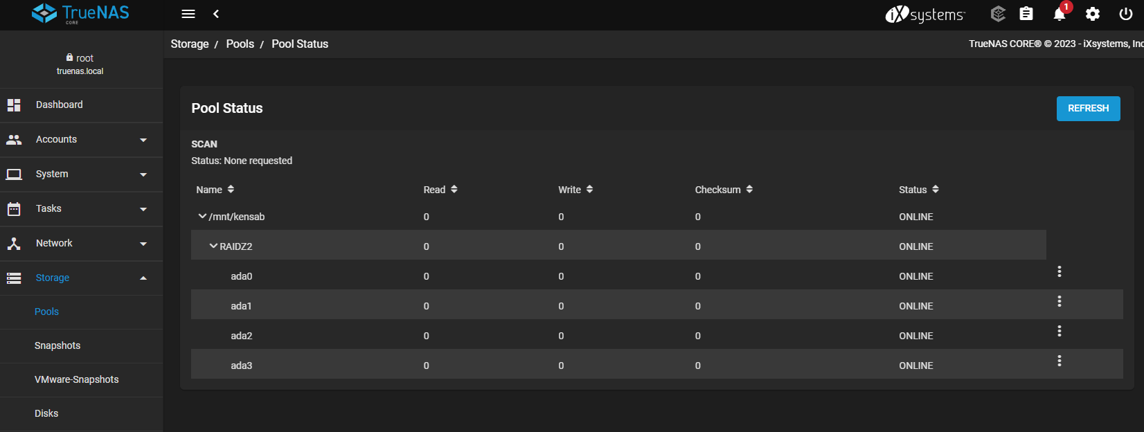

basnek
Feb 2, 2023
20
My TrueNAS working Thx to all!
