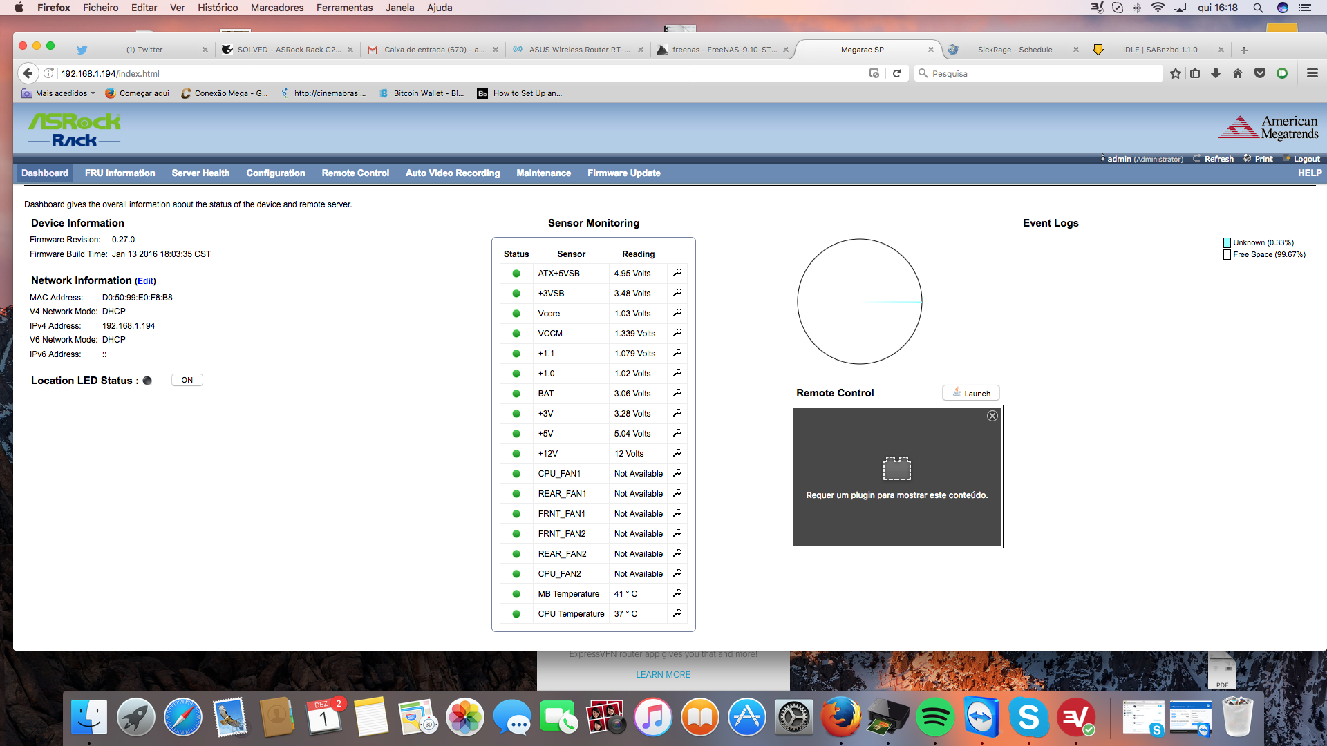

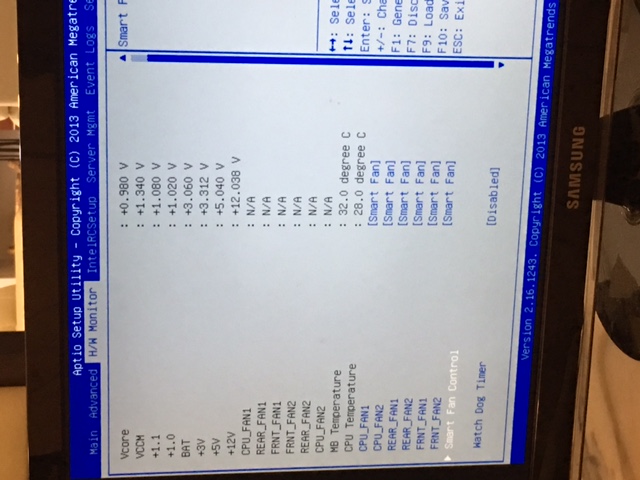

I have this values of temp:

i have this on ipm:

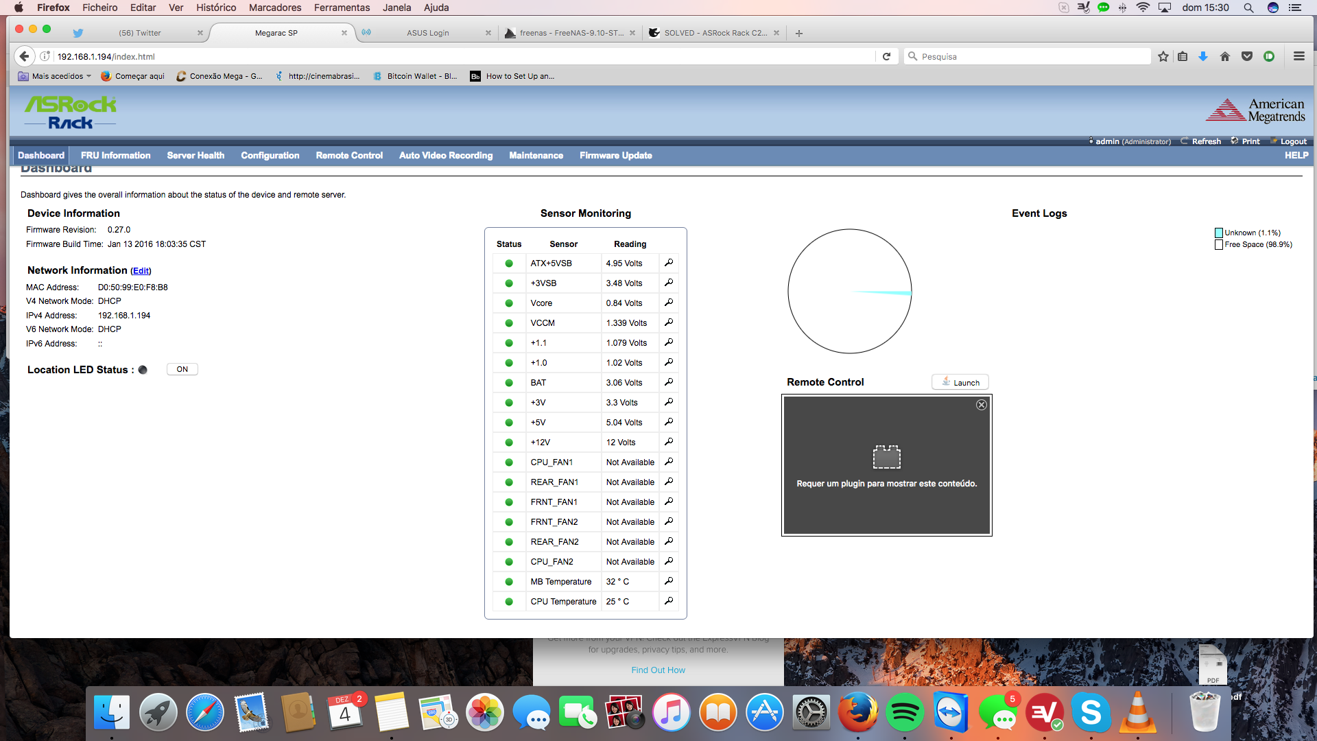

with freenas online
This is the valous for 4 fans (1 at front, 1 at the left, 1 behind, 1 up)

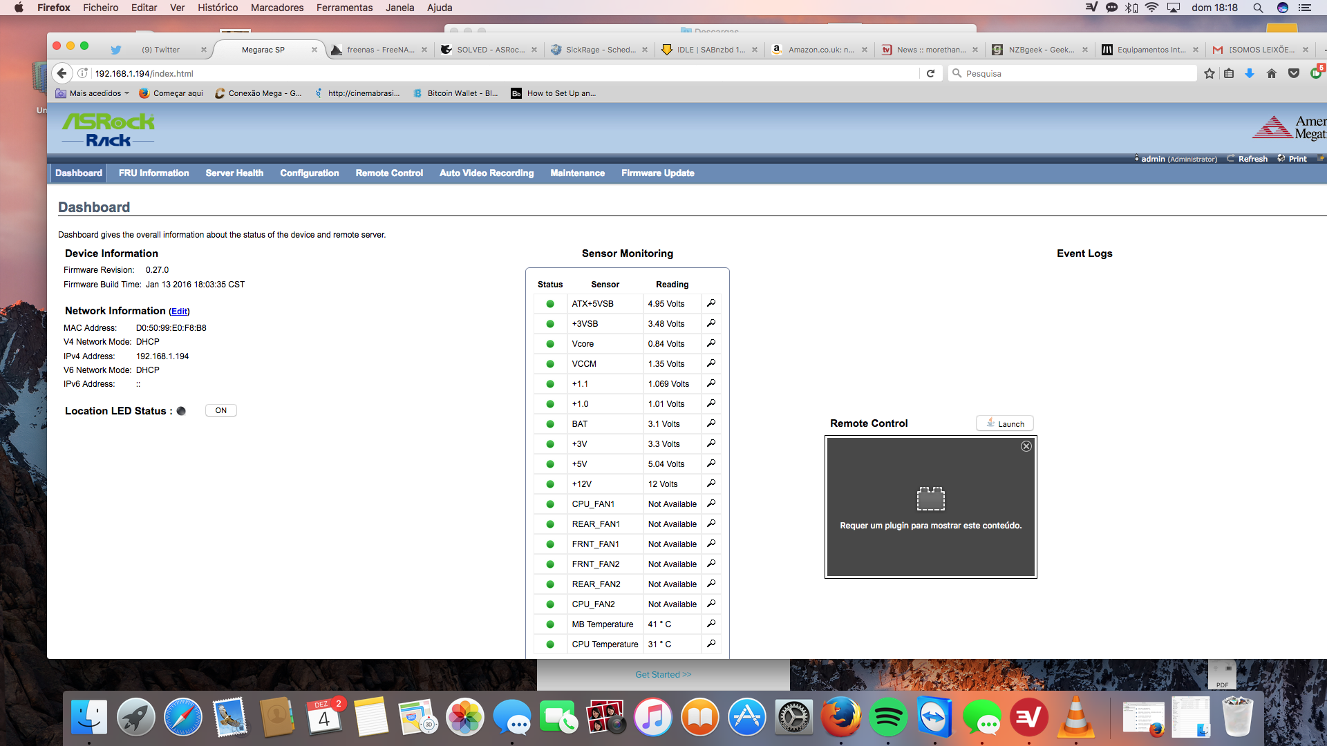

The left fan makes some noise, so i take it out.
And the values now
