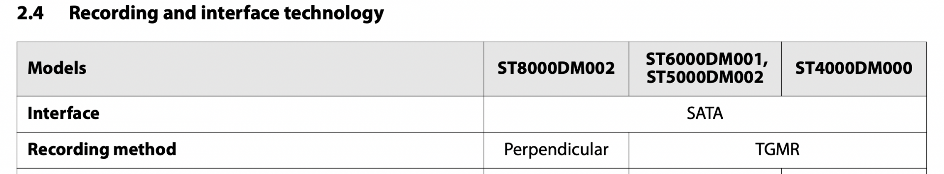

Not sure how one can come to that conclusion based on a product manual revision history that indicated that the recording technology changed to SMR for model ST4000DM004. You need to look at the product manual for model ST4000DM000, which according to Seagate's own product manual are TGMR (a form of SMR)
https://www.seagate.com/files/www-content/product-content/desktop-hdd-fam/en-us/docs/100782401d.pdf
TGMR recording technology provides the drives with increased areal density.
btw, "TGMR" should be considered to be a form of SMR, and generally avoided if you're interested in NAS/SAN (or similar) applications.

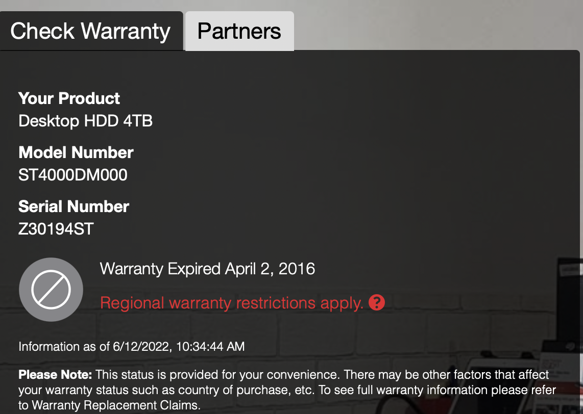

OP’s drives were all manufactured in 2015, a year before the revision from the spec sheet in your link (2016).

OP’s drives were all manufactured in 2015, a year before the revision from the spec sheet in your link.

The OP's drives are TGMR, which is a form of SMR. Its clearly listed in the following link
Regardless of root cause, used desktop TGMR drives were a poor choice.

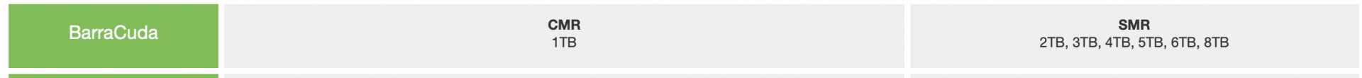

Seagate's own FAQ post.
Data sheet states TGMR, which from what I have read is a form of SMR

The linked FAQ does not list how the SMR usage has changed throughout the years, it just shows what the status was at a specific moment in time.

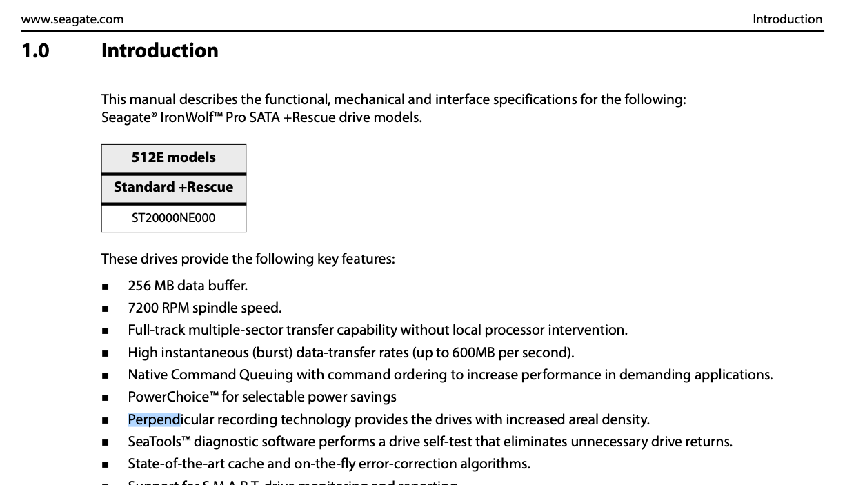

Here's the comparable sections from this product sheet:
The wording (describing increased areal density) is the same as for TGMR as it is for the 20TB Ironwolf Pro model linked above, clearly a model not believed to be SMR.
Again, not saying that the drives in question can't be SMR. Just that them being TGMR is not conclusive evidence one way or the other.
