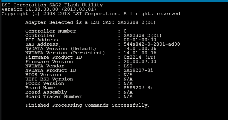

Hi Samuel,
I flashed it mode on it about 6 months ago when it was in another system (that system never had this issue)
Please see the results in the image, the card is a LSI SAS 9200-8e

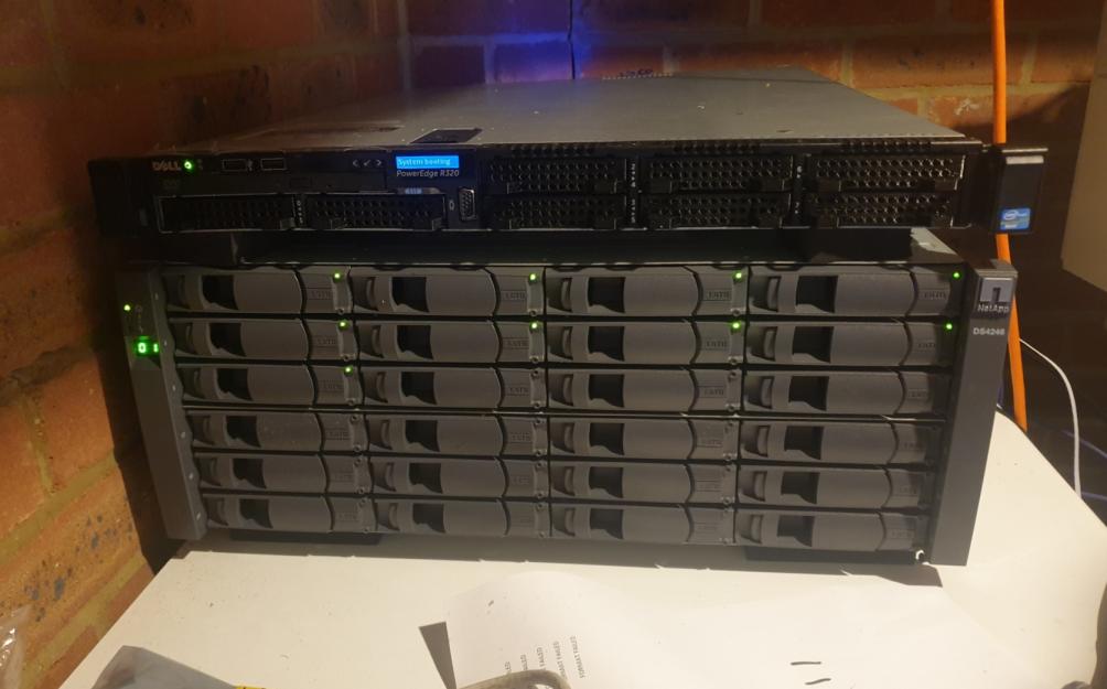

This is my setup, R320 with E5-2450L and the LSI connected to the shelf using 2 cables

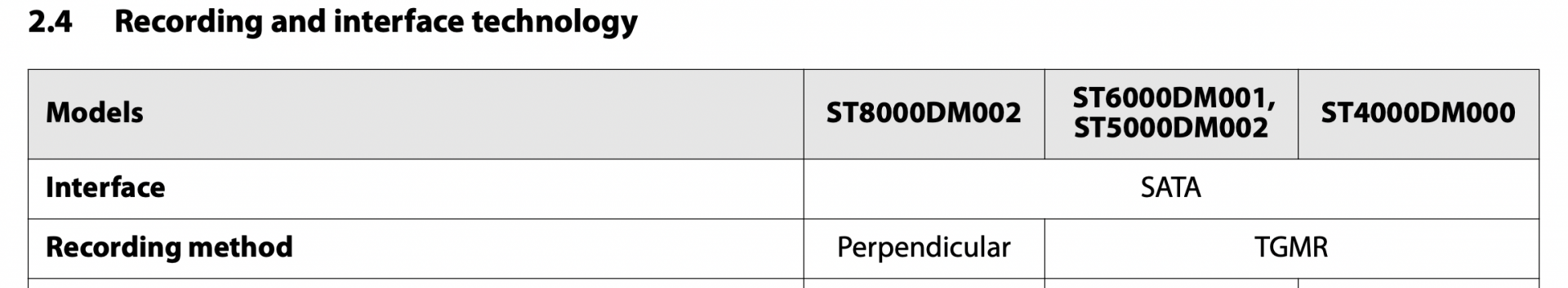

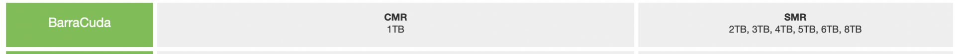

Seagate's own FAQ post.
Data sheet states TGMR, which from what I have read is a form of SMR

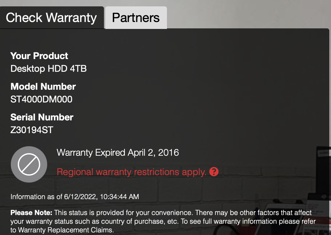

You apparently chose to buy used drives that are out of warranty.
