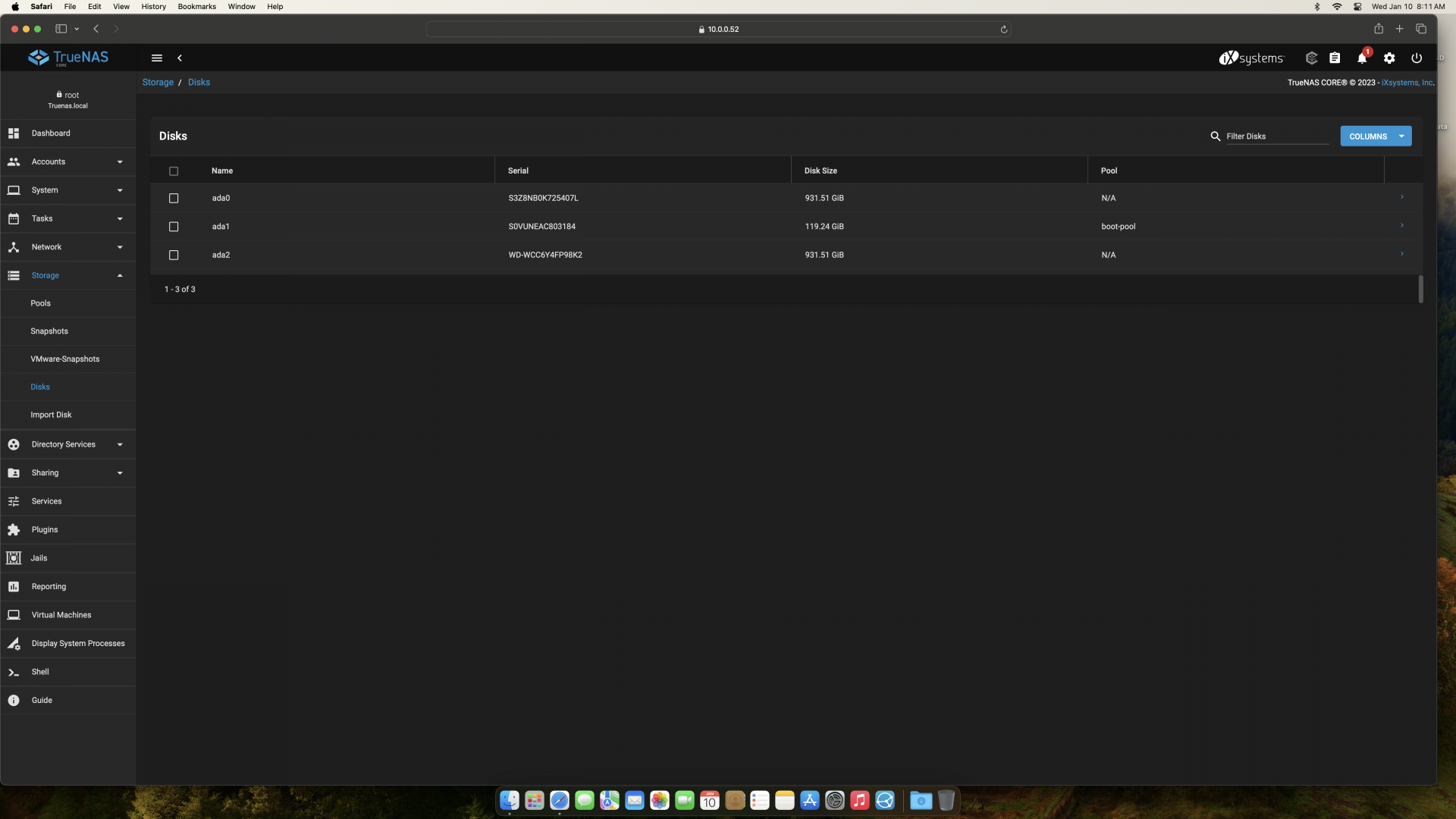

Just plugged in a new WD 1TB drive and it was recognized immediately. All other drives that were part of a ZFS1 pool are unresponsive after moving them to a newly installed TrueNas Core.. Any Idea?

Having ZFS "formatting" (really just a GPT with a designation for the second partition as ZFS) doesn't (and I don't see how it could) render a drive unable to spin up.
I understand that this doesn't match with your experience, and I'm not trying to gaslight you, but rather hoping you can think a bit harder about what's going on (that I can't see, since I'm not in front of it) which may be the true cause.

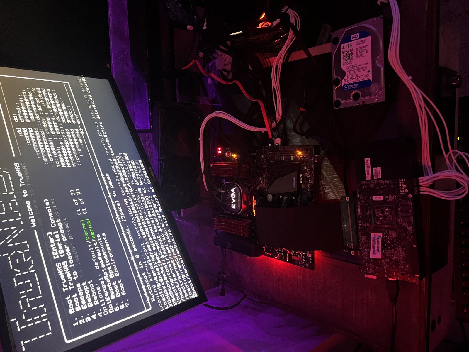

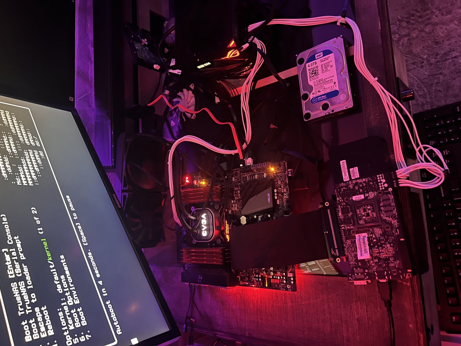

About seeing my setup, it is a mess

I can't really get a handle on where the drives are (except the disconnected WD Blue drive you have in the front there)...
Knowing at least this, I have 2 suggestions:
1. the drives are in a part of the "case"(?) which isn't getting sufficient airflow and have overheated at some point (or all the time) and are now dead due to some component burnout.
2. the drives are not NAS drives, so have not survived being run on ZFS as long as they were (I had a bunch of WD greens burn out on me in the early days when i thought all disks were the same)... the head-parking behavior that those drives try to do (without intervention from the wdidle utility) is likely to kill them in a few months of operation.
If you can't even get them in the BIOS, they aren't disks anymore, just paperweights.

First, thank you for all the great suggestions!
1. Even though it is not clear from the picture, all the hardware sits on top of a glass surface. Free airflow at room temperature ( -16 Celsius).
No risk of overheating.
2. I know that all the drives used are not NAS drives. I just grabbed whatever I had around to test and learn about TrueNas Core and they worked perfectly on the old build. When I unplugged the drives from the old build and installed in the new system, they stopped working ( sata drives are fine).
