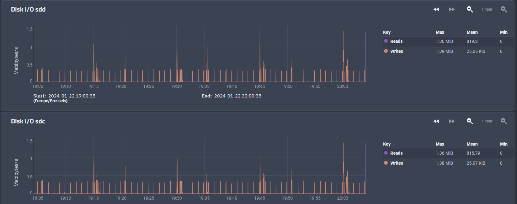

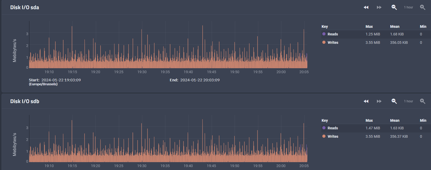

And I forgot to mention that the SSD Pool is also affected by this activity, accordingly to these graphs :
HDD Pool :
SSD Pool (Here, I have some services running, so that's a bit irrelevant, but i'm pretty sure pikes are comming in same time as hdd ones) :

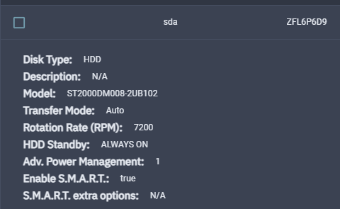

The results: Over 65 minutes the drive spin down and back up 64 times. That is at a rate of one spinup every .9846 seconds (slightly faster than once a second). ~1 minute. That is crazy!
Your drive wants to sleep. I did a quick internet search and there are complaints about Barracuda drives having this property in many systems but not all.
Question Time:
1) What version of SCALE are you running?
2) In the TrueNAS GUI, take a screen shot of the disk drive power management (I want all the data for the drive). GUI -> Storage (left side of screen) -> Disks (right side of screen) -> locate drive "sda" and click on the down arrow (right side of screen). Snap a shot of all that data to the left. I want to know if you have some power management setup issue.
EDIT: Updated as I apparently can't do simple (and obvious) math while tired.

I'm currently on this version : TrueNAS-SCALE-23.10.1.1
And that's the data of my disk :)
