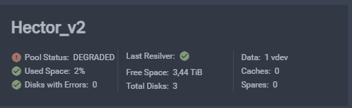

My two new disks are now up and ready !
But my pool is always tagged as degraded on the dashboard, but I don't see anything when i go to the pool.
Do you have any ideas why ? I ran a manual Short S.M.A.R.T. test after I installed new disks, but always seems to be degraded :(
Odds are you have some ZFS errors. Run the commands:
1) zpool status -v Odds are you will see some errors.
2) If you have errors then run zpool scrub Hector_v2 -w and wait for the scrub to complete. The command line will be unusable until the scrub is completed. Remove the "-w" if you want the command prompt back immediately and scrub to continue in the background. I'm saying to use the "-w" so you will know when the scrub is complete, the prompt will return.
3) Run another status check (Step 1).
4) Do you still have errors? If the errors are READ/WRITE/CKSUM value not zero only, no files listed as corrupt and must be deleted then go to step 5, otherwise you will need to delete those files first. Post the output of the status command if you have any questions about what you are doing.
5) We should be able to clear the errors now by running zpool clear Hector_v2 and then perform step 1 again. All should be good. If not, post the results of the above steps.
Let's say we clear the errors. Odds are these will return as long as you are using the SMR drives and writing data.
Why does this happen? This means is the drive is asked for data but if fails to return it fast enough then an error is created. It does not mean your data is corrupt in this situation.
Please understand that I generalized some of the stuff I said above, enough that a person can understand what is basically going on.

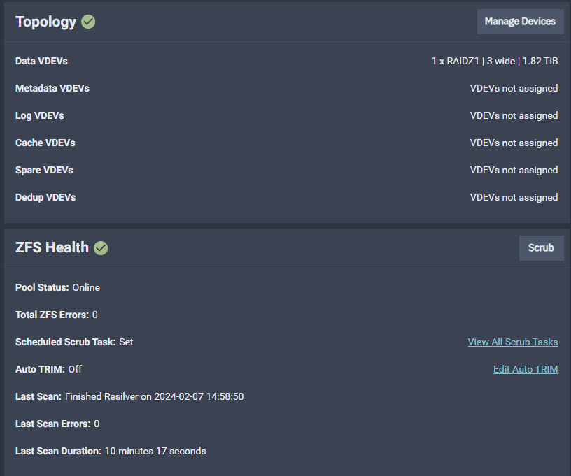

I was going to TrueNAS to do what you said here, and I saw that the error had gone. Maybe it just needed to quietly do a few scans or something.
Thanks for everything, now that my main problem is solved, I'm going to leave the hardware alone for a while until I change my next disk.
