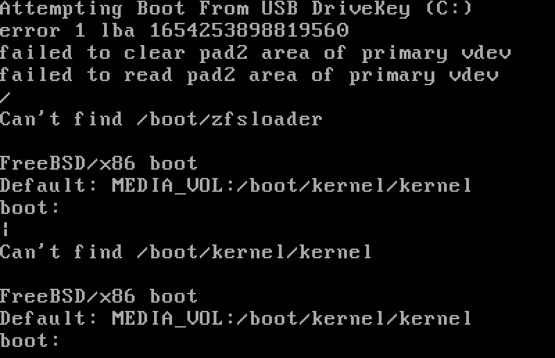

same problem here ...
had successfully upgraded last week from 11.1-U6 --> 11.2-RC3
all was running well so far until today I upgraded from 11.2-RC3 --> 11.2-REL
and I have ended up with "can't find boot/zfsloader" error message on boot
The only thing that wen't wrong this time was the upgrade process disrupted when the USB drive got full during download time. The I repeated the process and it seems the 11.2-RC3 boot version had been replaced by 11.2-REL with a message "please boot to activate"... the rest is history :-(
any advise for helping me recover is greatly appreciated.

this is what I have tried so far ...
Try #1
1. Using install ISO on usb key, upgraded to 11.1-U6 by selecting reformat boot, BIOS boot
2. Freenas DB was upgraded with errors
3. booted to FreeNAS, all jails and VMs booted correctly
4. System Menu (legacy) throws errors and cannot use at all
5. System Menu (Angular) works with no errors; can select upgrade menu but a spining dialog never goes awat
Try #2
1. Using install ISO on usb key, upgraded to 11.2-REL by selecting reformat boot, *UEFI* boot
2. Freenas DB was upgraded with *no* errors
3. cannot boot, getting boot error "cannot boot from data partition"
Try #3
1. Using install ISO on usb key, then upgraded to 11.2-REL by selecting reformat boot, *BIOS* boot
3. cannot boot, getting again the below screen - hence it is unlikely to be bad sector on the boot device
Try #4
1. Using install ISO on usb key, then do a fresh install for 11.2-REL by selecting reformat boot, *BIOS* boot
2. cannot boot, getting again the below screen - hence it is unlikely to be bad sector on the boot device
There is also an relevant open ticket here...
https://redmine.ixsystems.com/issues/52441
Weird how I was successful from 11.1-u6 --> 11.2-RC2 !
