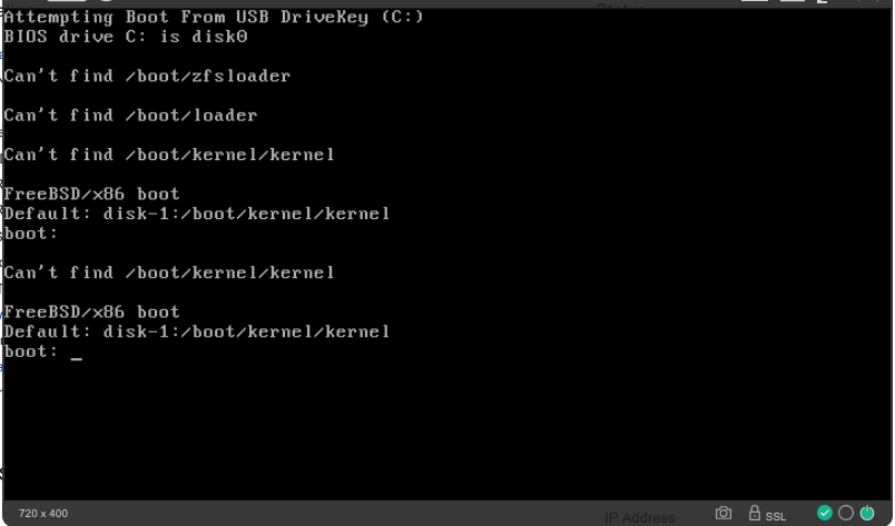

I had a problem with my installation and had to do a fresh install. But after installing and booting, I have the same error.
My hardware is an HP Gen8 and I installed it on a flash drive. I've always had it installed like this and it has always worked for years but now starting the new version that I downloaded, I have this error.
