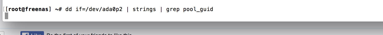

Terence Faul
Aug 12, 2015
45
Nope I am still waiting, each drive is 2TB. (See attached)
I only get a quick response if I run it on the boot device (The New fresh install USB I made)
titan_rw
Sep 1, 2012
586
Stop it then. It's just wasting time.
Try this:
dd if=/dev/da2p2 bs=1k count=1k | hd | grep "0c b1 ba 00"
That searches the first megabyte (1024*1024) for uberblocks. Should only take a few seconds.
I've got 64, from offset 20000 up to 7f000.
Change the drive of course.
Running it against one of my boot drives I get 256 uberblocks (lines).
