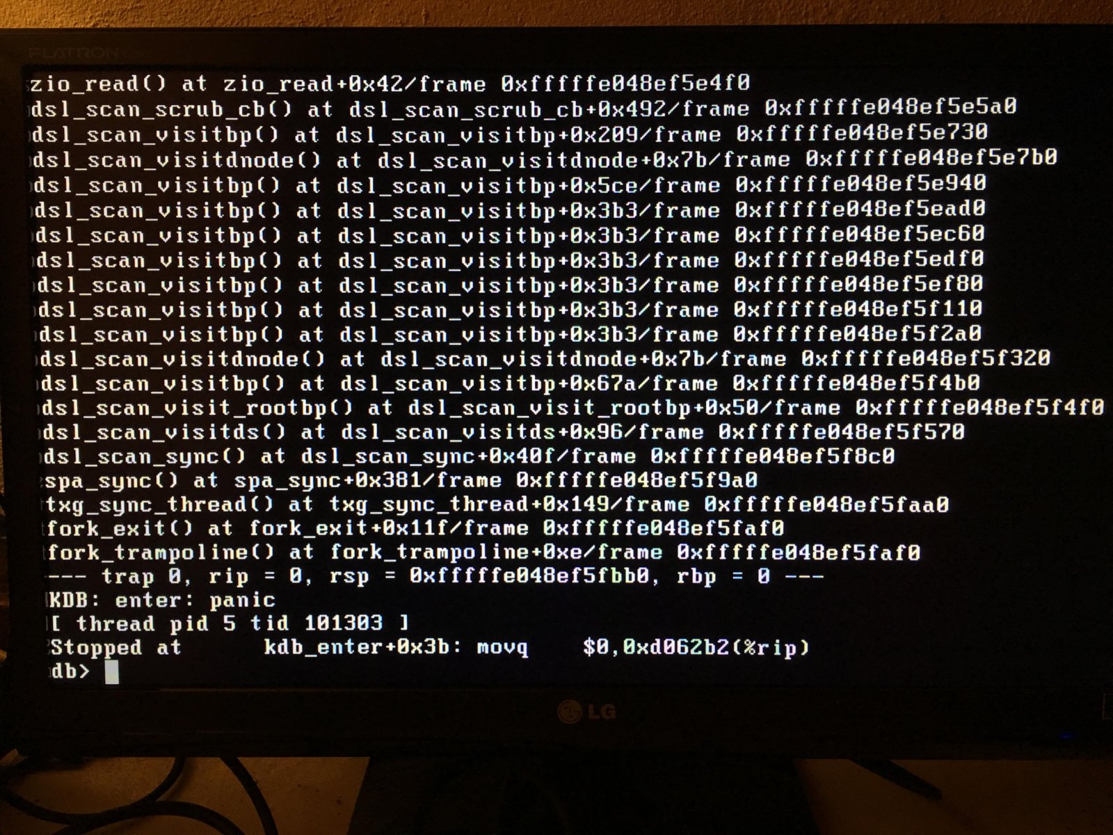

Hi
Please help, my Freenas box had a panic in boot. As a result I built a new boot drive and booted the system.
I am now trying to import the zpool volume to the new system, but the system is not picking it up.
I tried through the GUI but there are no volumes to import.

LABEL 0
failed to unpack label 0
LABEL 1
failed to unpack label 1
LABEL 2
failed to unpack label 2
LABEL 3
failed to unpack label 3
[root@freenas] /# zdb -l /dev/ada1
LABEL 0
LABEL 1
LABEL 2
LABEL 3
[root@freenas] /# zdb -l /dev/ada2
LABEL 0
LABEL 1
LABEL 2
LABEL 3
[root@freenas] /# zdb -l /dev/ada3
LABEL 0
LABEL 1
LABEL 2
LABEL 3
[root@freenas] /# zdb -l /dev/ada4
LABEL 0
LABEL 1
LABEL 2
LABEL 3
I am not getting a good feeling about this
