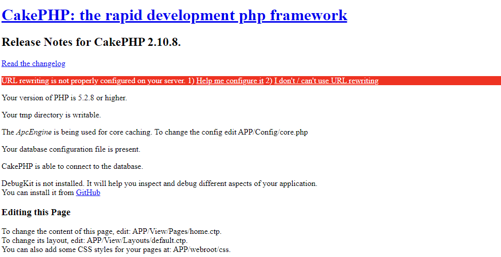

On zoneminderip/zm/api i get this:

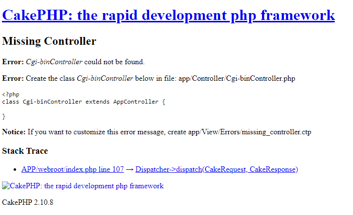

Under zoneminderip/zm/api/cgi-bin I get now this Error...

Yep this is where I'm at as well. Did you have to make the directory like I did?
