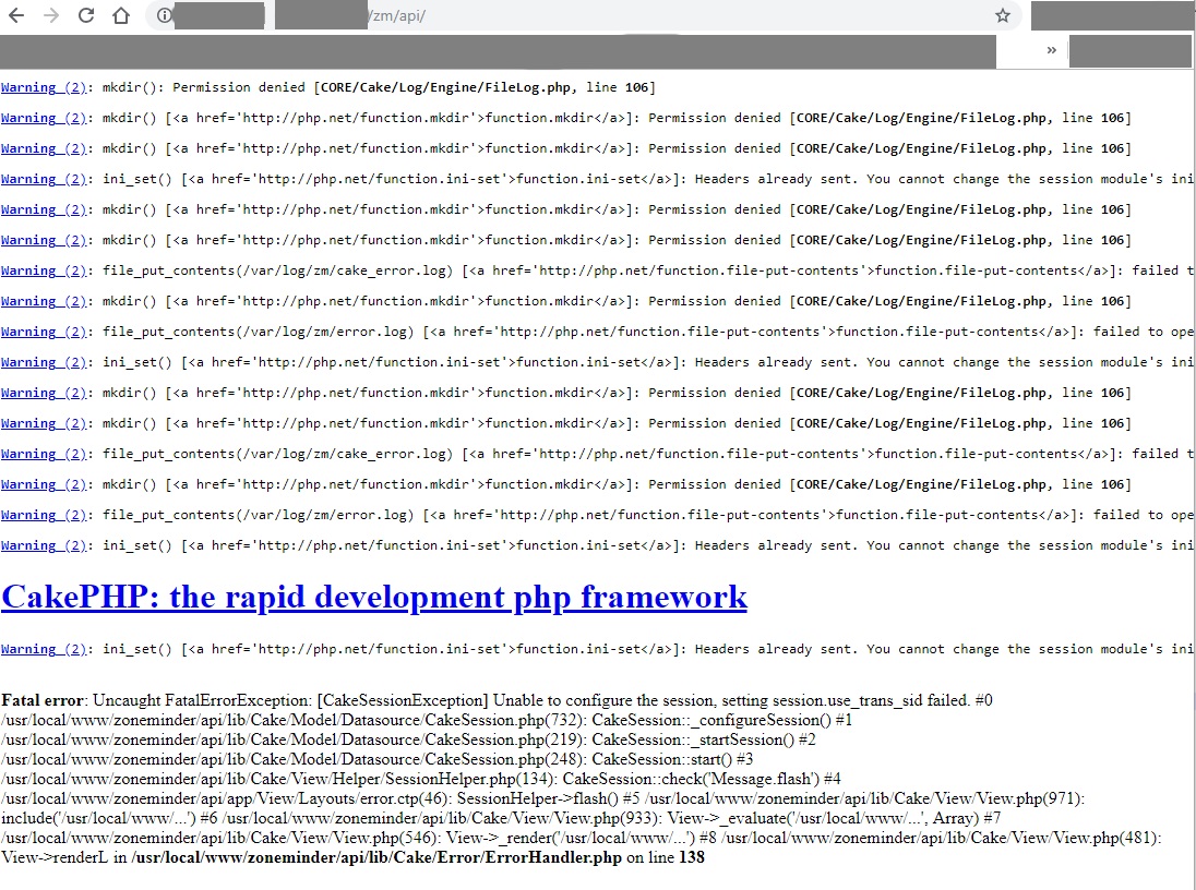

Hi, do you have API working with Zoneminder Freenas Plugin?
I receive cakephp fatal error, navigate to http://myip/zm/api
Any suggestions for me?
If you read all errors more closely, you may notice that it is trying to write a log file to /var/log/zm/
Make sure that the folder exists with correct permissions.

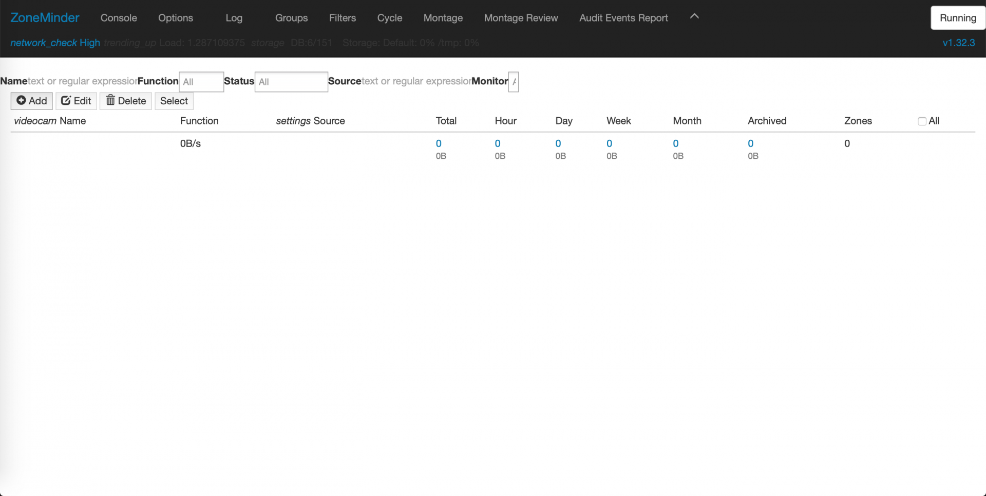

Hi, I finished the guide on 11.1 U6 however I cannot add any cameras (nothing happens when I press add button) and I think my javascript isn't loaded correctly. Any ideas?

tuplink
Nov 24, 2017
i ran into this issue too along with a bunch of others. if you look at the source of the page you will see that the css uri is server.tld/zm/xxx.css
HTTPD.CONF (the first redirect was the cause of most of the issues as the source has some references to full path resources like server.tld/zm/xxxxx, however after going through this tutorial that path dosn't exist, its in the root of the uri)
<VirtualHost *:80>
ServerName whippet.domain.tld
ServerAdmin email@example.com
DocumentRoot "/usr/local/www/zoneminder/"
ScriptAlias /cgi-bin/ /usr/local/www/zoneminder/cgi-bin/
<Directory "/usr/local/www/zoneminder">
Options FollowSymLinks
AllowOverride All
Require all granted
RewriteEngine on
RedirectMatch "^/zm/(.*)" "/$1"
</Directory>
<Directory "/usr/local/www/zoneminder/cgi-bin/">
Options +ExecCGI -MultiViews +SymLinksIfOwnerMatch
#AddHandler test-cgi .cgi .pl .py nph-zms zms
AllowOverride All
Require all granted
</Directory>
<Directory "/usr/local/www/apache24/cgi-bin/">
AllowOverride All
Require all granted
</Directory>
<Directory "/usr/local/www/zoneminder/api">
RewriteEngine on
RewriteRule ^$ app/webroot/ [L]
RewriteRule (.*) app/webroot/$1 [L]
RewriteBase /api
</Directory>
<Directory "/usr/local/www/zoneminder/api/app">
RewriteEngine on
RewriteRule ^$ webroot/ [L]
RewriteRule (.*) webroot/$1 [L]
RewriteBase /api
</Directory>
<Directory "/usr/local/www/zoneminder/api/app/webroot">
RewriteEngine On
RewriteCond %{REQUEST_FILENAME} !-d
RewriteCond %{REQUEST_FILENAME} !-f
RewriteRule ^ index.php [L]
RewriteBase /api
</Directory>
LogLevel debug
</VirtualHost>
