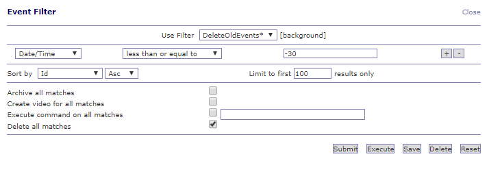

Also: Would appreciate recommendations on how you're handling storage. Where are you saving events and video files?
By default, the folders get generated from the install at /usr/local/www/zonemidner. Basically you will be using your jails storage unless you choose a different location. As long as you're jail is running in a good sized pool, you should be fine.
The way you manage storage is through the Event Filters on the web gui. By default, there is a Purge When Full event already enabled. It is set to when your disk reaches 90%, it will record over the oldest event. I added my own event to delete anything older than 30 days, as I think that's a decent time frame. Here is a snip of what my filter looks like:
Once you save, just make sure you check the "run in background" or it won't run automatically.
joebad1
Nov 21, 2015
58
Excellent information, thanks!
